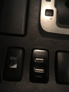

I installed one of these dual 2.1A USB ports on the front dash area just below the hazard light button. It works for both iPhone and Samsung S7. Just removed the dash AC controls to get access and drilled the hole in the panel in an area with clearance. I also added a second one that displays the voltage of my 2nd battery. The same company also makes a rocker button style.

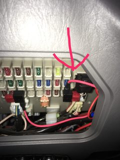

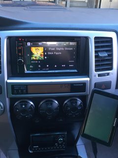

I did something similar today, but wanted an xtra USB port for charging 2 USB's at the same time in addition to connecting to my Kenwood. I did have to run separate power to the charge slot, but an add-a-fuse made that pretty straight forward.

Did the new usb plug fit flush/tight into the old cig lighter? I ordered the same chord but mine doesnt fit snug
