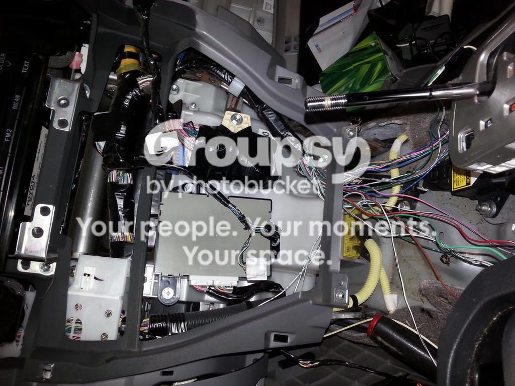

My first step was to install LED glovebox and shifter light. Then remove all center console covering. After that i move to the center dash and remove the plastic cover.
Next I stripped the electrical tape/plastic sleeve from the wiring harness (i used a rounded exact-o knife for accuracy.
I stripped up to the point on the right of the photo. I removed the driverside dash under the steering wheel and prepped the area (just took out the empty button). Next i routed the DAC wires (notice on the left of the picture three visible wires running from right to left along the middle bottom area) to the drivers side where i removed the empty button.

As you can see from the photo on im starting to clean up the cable and recover it with the plastic/tape.
Dont worry about other wires in this picture they are related to another project I was working on. I was wiring my PIAA 520 to a FJ switch without a harness (previously worked but the backlight wast hooked up)
