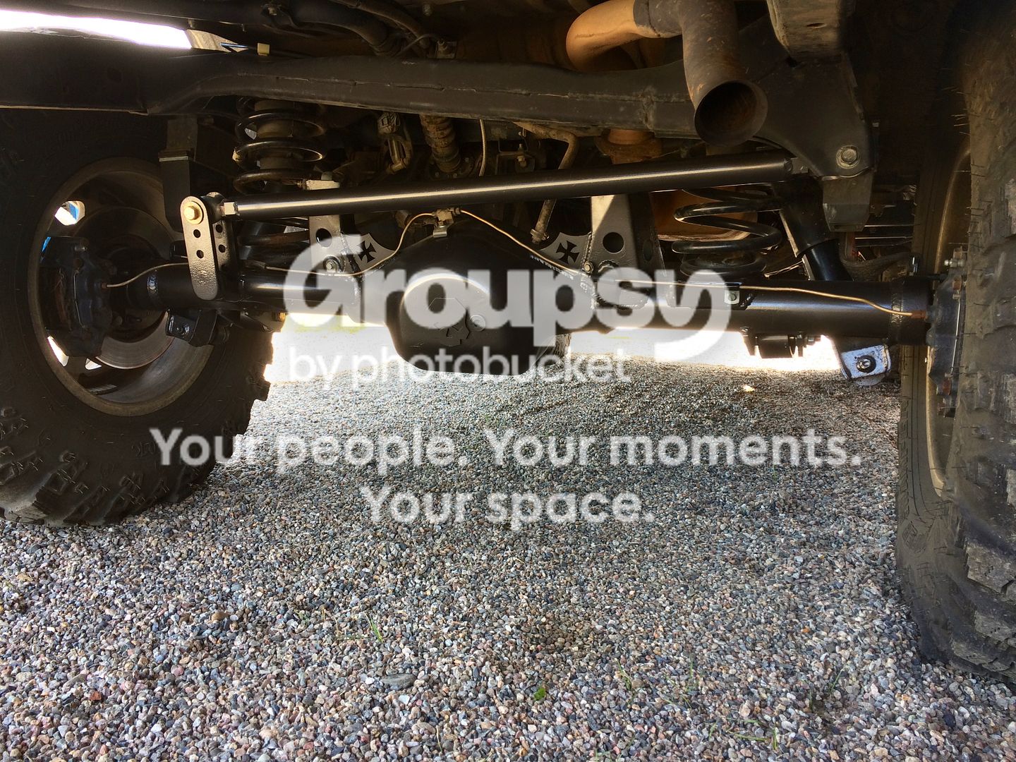

Really like what [MENTION=67615]Dirtco[/MENTION] did here:
IMG_4215.jpg~original
Another cool option for the 3rd gen guys. Gunna have to dig and compare some numbers.
