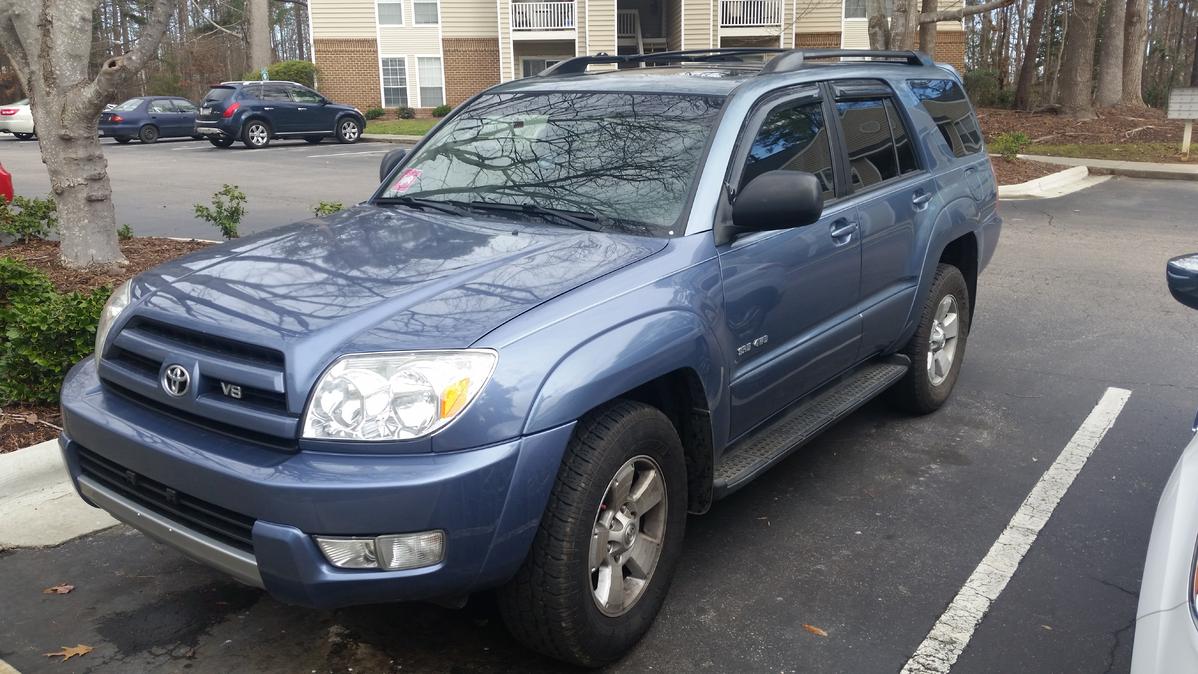

I bought a 04 4runner V8 in Pacific Blue with 165k miles. I know very little about working on cars and want to use this car to learn about cars and how to fix cars. The car is in really good condition minus a few things that need to be fixed or upgraded.
First and foremost is there anything I should be checking or replacing?
I know the belt just got replaced before I bought it. It needs a battery and probably brake rotors/pads.
On that topic how hard is it to replace battery and brake rotors/pads? Also which brand of products do you go with for things like this?
Secondly on smaller cosmetic areas. The main console behind the a/c knobs, lights are burnt out. I tried looking for parts but the diagrams are confusing and I don't understand what I am looking at. There is also a scratch going across the face of the led screen where your mpg, ac temp and weather temp are displayed. Is there anyway to get a new screen for that?
Any help would be greatly appreciated.
Thanks
