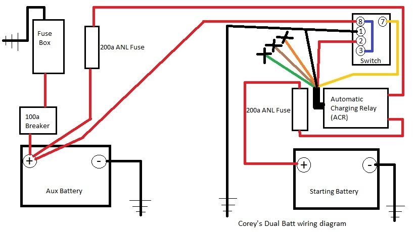

I did get my dual battery setup drawn out yesterday (pic is missing the circuit breaker which I added later, and changed the inline fuses to 200a).

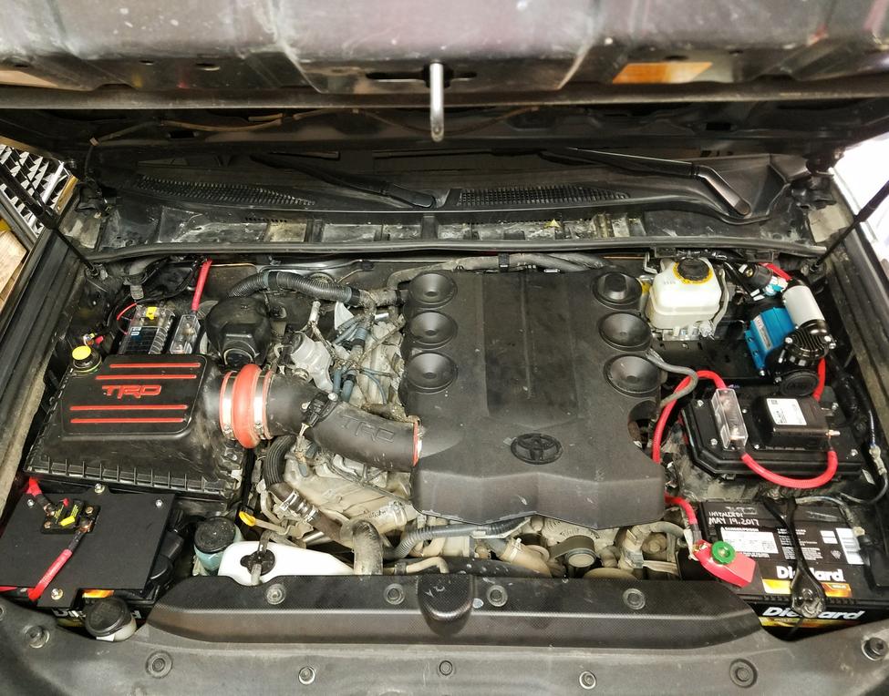

The install:

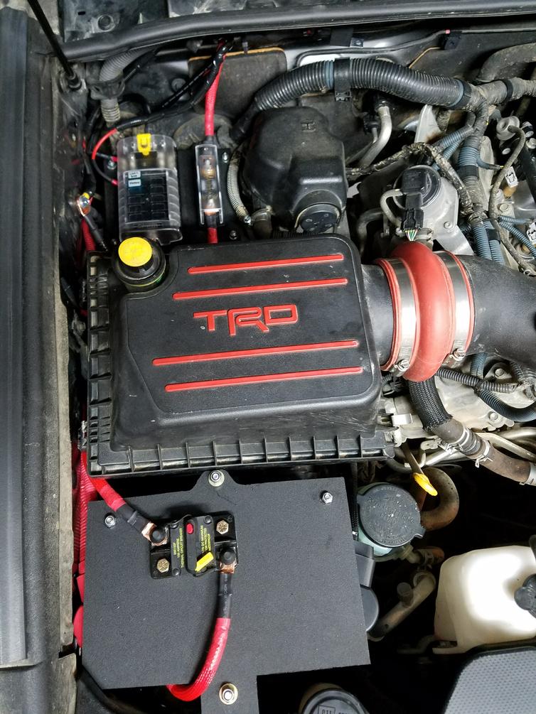

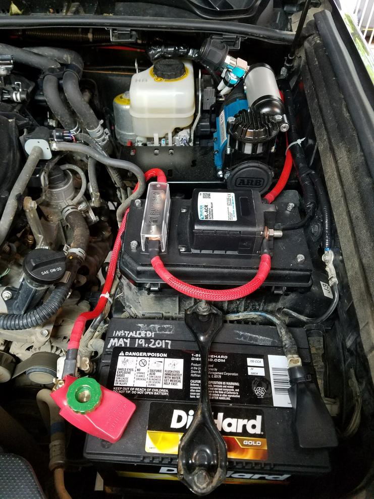

After the air pump was moved I put in the the two new Diehard batteries. You will notice that the terminal connectors to the stock battery are in a different location than on the Die Hard batteries. For the negative cable, I used two pair of pliers and I carefully bent the stock negative connector as straight as I could. For the positive side, I used a Battery Disconnect terminal. It was the longest terminal I could find and it barely reaches the positive side of the terminal, but it works. You will need a longer bolt and nut for this terminal because the connector is fatter than the stock one and you will be attaching another ring connector to the existing stock one. I covered it with a flexible terminal connector and cut out a hole for the release knob.
The Schrockworks bracket for the Aux Air Pump (pass side) makes an excellent mounting point for some of the Blue Sea components. You will have to cut the starboard to make several places to mount the ACR, fuses, fuse box, and breaker. I used nuts and bolts to attach them to the truck, and used t-nuts to attach the components to the starboard. Keep in mind that you will need to run wire to all the components, so be cognizant of how much space you are leaving between and around the components when mounting. You can mount them in any location you wish. Because I have my ARB compressor mounted on the driver's side, that sort of eliminated a lot of space I could have used for mounting my battery setup components. I did not want to fill up the bracket, in case I end up with a dual compressor down the road. The ARB dual compressor bracket came from SLEE Offroad and is a very well made bracket. You have to call them to place an order, which sucks, but they are very nice and it was shipped the same day. I chose to make a starboard mount that mirrored my stock fuse box, to mount the ACR and the inline fuse on the driver's side. If you do this just take note of the stock fuse diagram on the inside of the lid and plan accordingly. My hubby also made the mount that is over the top of the Aux battery for the breaker. He designed it so that it stands off above the terminals of the battery, and has small feet to hold up the corners. He used some bolt extenders, washers, and threaded rod with nylock nuts to attach it to the battery j hooks above the battery hold down.
Once you have all of your components mounted you can begin the work of creating all of your connections. I wanted everything color coated which is why I used the Techflex instead of plain black wire loom for everything. I wanted to be able to see where all of my connections were and wanted them obvious in case I need to do any trouble shooting down the road. I did remove the air box just to get it out of the way while I was working, but be mindful of how much space the box needs when running your wires to the aux battery. I used a colored pencil to outline where the box was against the fender side.
When making my terminal connections on the 4 gauge wire, I would cut the plastic off the end of the wire according to how much needed to fit into the terminal connector, put some dielectric grease onto the wire, slide the terminal connector onto the wire, then use my 3lb hammer and the lug crimping tool. It takes a bit of effort to crimp the large wires, so I did this on the concrete floor of the garage. I would double check that the terminal was tight on the wire by yanking on it a few times, then use the marine heat shrink to cover the connection where the connector meets the plastic of the wire. I would attach the terminal to the appropriate component, then measure/roll out the wire to how long the wire needed to be, to match up with the next component. Do this carefully and take into account zip tying it into place. You can bend it into place and make a note of how the next connector needs to be oriented. It won't hurt to have a few extra ring terminals in case you screw up and have to re-do any of the wires. After I measured the length, I would attach the second ring terminal using the same procedure, then cover the wire with Techflex and tape it into place with the electrical tape.
Making all of the connections takes an incredible amount of time. Go slowly and remember to use the marine heat shrink on all the ends and use the Techflex to protect all of the wires.
After I got everything connected I kept the breaker tripped, and did not put in the fuse coming from the start battery. I wanted to get the switch wired up and ensure it worked correctly before "going hot". I did have to make a trip to Jeff's and he was able to:
A. explain/show me how the ACR works, and...
B. make sure I had everything wired up correctly
If you look at the wiring diagram drawing I made, the brown wire running from the ACR to the "Engine/Start" will not be used. Neither will the green wire or the orange wire. You will have to create a "wiring harness" of sorts that runs through the firewall, into the cabin to your switch. So you will need to solder some length onto the ACR wires (which are incredibly short) and marine shrink wrap them. I labeled all of the wires with some tape before running them through the firewall so I wouldn't get confused. This is also a good time to run the one red wire from the aux battery to the switch as well (I forgot to do this, so had to do it later).
The ACR comes with a red Carlin style three position switch. On/Auto/Off. Using the wiring diagram I have here, if you connect everything up, and set the switch to "Auto" the ACR will click on about a minute after the engine is started. After the engine is turned off after about a minute the ACR will click off. You can test this without the engine actually turned on. The ACR makes a very audible thunk/click/clunk sound when it comes on and doesn't sound like any other component under the hood. It is very obvious when it comes on. In hindsight, I probably should have temporarily wired up the switch (before running the wires through the firewall), and tested everything before I ran the wires into the cabin, but I got lucky and everything worked. Another thing... on the back of the switch, make sure you are using insulated terminal connectors (Jeff yelled at me for not doing that so I have to go back and fix that this week).

I think this is it. Remember to be cognizant of where you are putting terminal connectors that are connected to the battery. I did accidentally drop a hot end of a connector onto metal twice during the install. It's a reminder to be more careful. For this reason, I recommend connecting to the battery LAST. Make use of the plastic terminal covers and don't rush the project. If you have to stop in the middle of the install and move/drive your truck, please make sure that you remove the ANL fuses and trip the breaker so that nothing is connected until you are completely finished and are ready to test the system and "go hot" so to speak. Please be safe.

It was a lot of work. In the end, I'm glad I did it, but it would have been easier with a couple people working on it over a couple days. There's a lot of details that have to be worked out before the connections can be made (where components are going to be mounted, does it make sense, etc). I was not mentally prepared for all that. But.... It's done and working and I'm a happy camper. I'm sure there are cheaper ways to get it done, this is just the way I decided to go about it. And... I have lots of leftover 4 gauge wire!
Quick question... Why not put the Aux Battery in the back where the air pump got relocated to?
Strength. I read in several other posts that the sheet metal in that area is not as strong. I found a small amount of information about some cracking when a battery was mounted in that location. The relocation kit from Schrockworks is very well made (not cheap either) and has really incredible instructions. It took a friend and I a couple of hours... mostly because we wanted to thoroughly read everything before cutting. The Schrockworks kit provides you everything you need to relocate the aux air pump.
