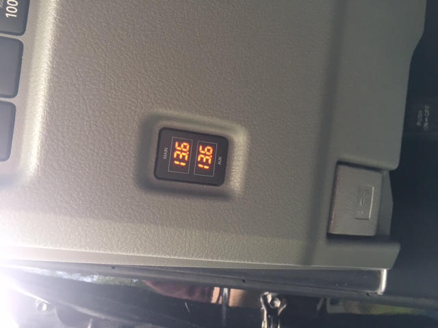

How about the switch you mounted next to the dual volt meter? Where did you get that? It looks pretty good mounted flush. I could use a few more switch spots mounted flush like that.
Here's a quick snap of mine lit up. I love it. It down far enough I don't see while driving, but every time I get in the T4R I see exactly what my levels are.
I have the same gauge. Love it! I use a switch next to it to turn it on and off.
-Edit to add my pic
Is the meter always on?
Yes, it's always on. If I remember correctly the back side has 4 wires, 2 red, 2 black. It wouldn't be to hard to add a switch of some kind. The easiest way would be to just break the ground connections that I wired together. Some sort of momentary switch would work just fine, But there's already a lack of switch space so I decided to just wire it up and see if I had any issues with it.
So far so good, but it probably should be wired in such a way that it's only on when the ignition is on or when you want to check the readings. The longest I have let the truck sit between uses is about 6 days (airport long term parking) and it's been fine starting up. However, I'm not powering a fridge or anything that is always on.
That shot was taken right after I started the engine one morning. Occasionally I will see it run at 14.1 for a minute or so(when it's real cold out) then it starts dropping back down into this range for the entire commute.

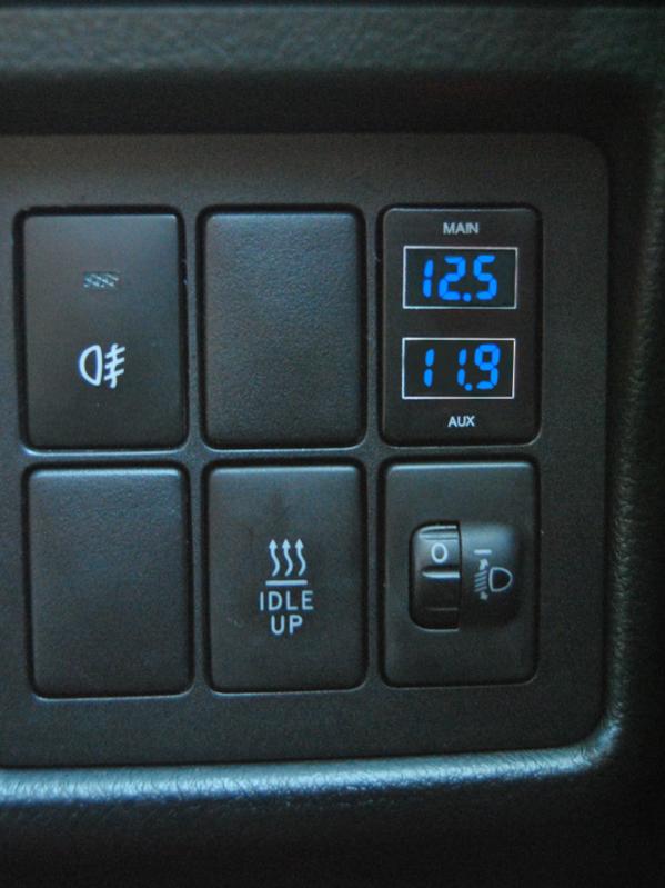

If you look at mine I put in a separate On/Off switch on my meter as I didn't want it always on.
