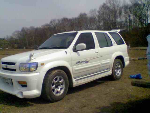

Hello.
I live in Russia. Now I own right handed Nissan Terrano Regulus 1999 with 3200 turbo diesel engine (aka Infiniti QX4 in U.S.) It has "All mode 4x4" drive with rear LSD. I'm completely satisfied with it, but now I want to purchase 4 whell drive, left handed Toyota 4 Runner 2003-2005 from U.S.
Please could somebody help me with my choice? Which specification is better (SR5, Sport, Limited) with 4700 or with 4000 engine? What is real average mileage of each engine with 4wd? And how to determine if the vehicle has the rear LSD?
Thank you very much.
