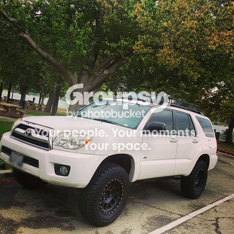

i was in the same boat i went with the toytec 2.5 and 5100 on the front. now the day i installed them i was set on putting them on stock notch but threw the dice and went for the second notch at the last minute and im glad i did. once it set in i think its perfect. i got the front alignment done and everything is with in specs with no issues. i was told i would have the freeway wonder but havent got that ive been on this set up for 5,000 miles already and no issues. i hope that helps let me know if u need any other info
