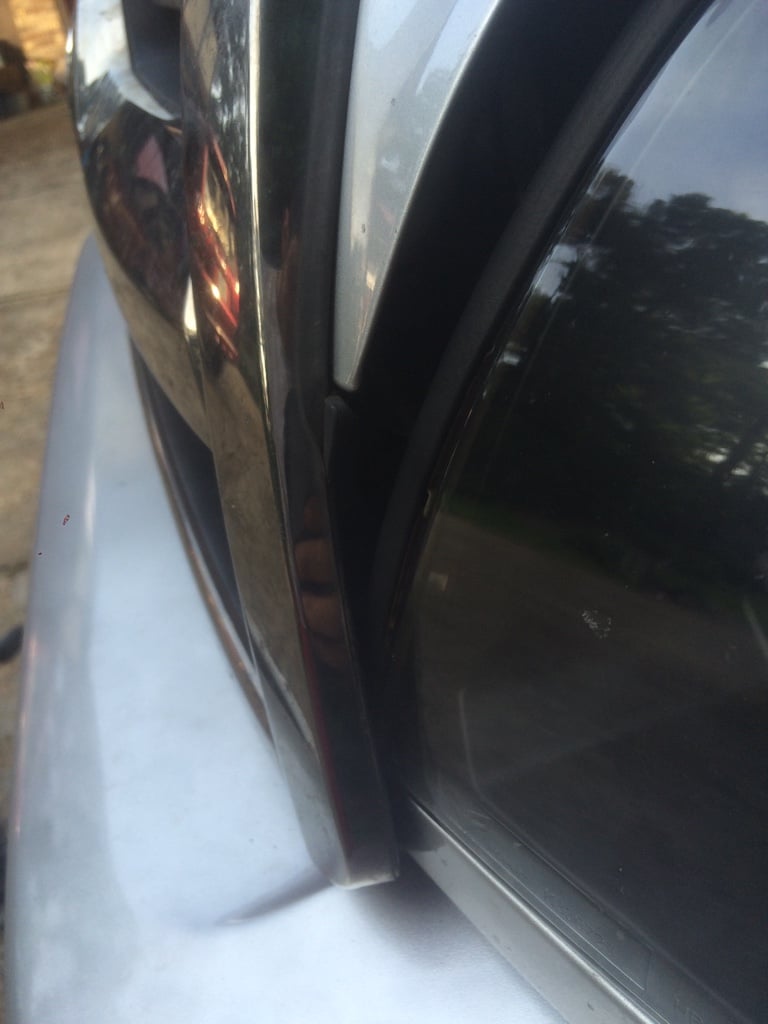

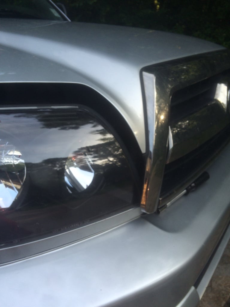

Yesterday I took my mom's 06 grille off and laid it down next to mine, just to get a good look at what differences there were and what I'd have to do to make it fit my headlights. After bolting the grille on, test fitting it showed that I'd have to cut away the corners of the grille to make it fit properly with the 03-05 headlights.

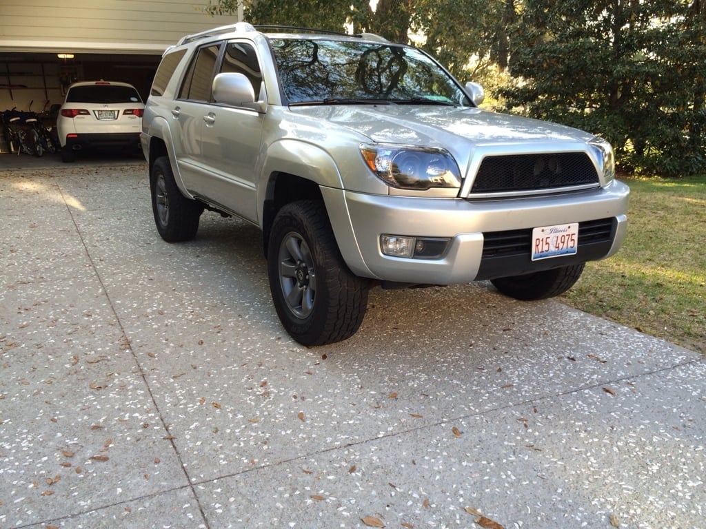

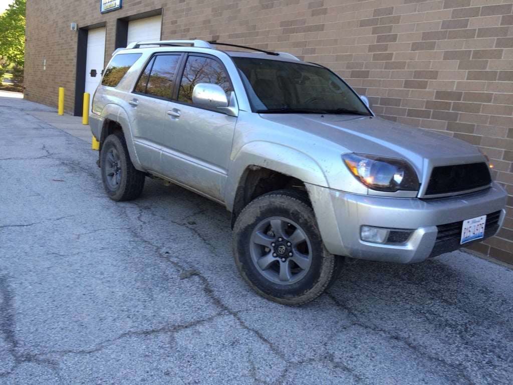

I choose this route as opposed to cutting the sides of the grille to work with my 03 headlights. The project really wasn't bad at all. I decided to trim down the grille enough so that I didn't have to trim the bumper at all and still keep the black trim on the top of the bumper.
Thanks for posting these pictures. Really helpful to see what needs to be trimmed in order to retain 04 headlights. My lights are retrofitted and I'm not looking to install more inferior 06 headlights with stock projectors. If I ever to re-do my retrofit, I would use 04 headlights again since they have way more room inside to mount larger projector such as TL or LS460. With 06 headlights you stuck with factory projector or retrofitting task would limit you in choice of projectors. I would rather cut the grill to fit.

All I purchased was, the grille (ebay limited unpainted), 06+ headlights (ebay dt moto), the trim under the headlights (amazon unpainted), and bulb sockets for the new turn signals (amazon). Since it went on a 03 bumper, I have to shorten the grille, because of this, I needed a different latch rod. I used a rod from an aftermarket door lock actuator trim and bent to fit and painted black. The latch mechanism swapped over from the stock grille. Everything I bought was obviously aftermarket, since you have an aftermarket bumper already you might not need to do anything special with the latch except swap it over from your original. Worst case you may need a new latch rod.
I can snap more pictures if anyone needs.

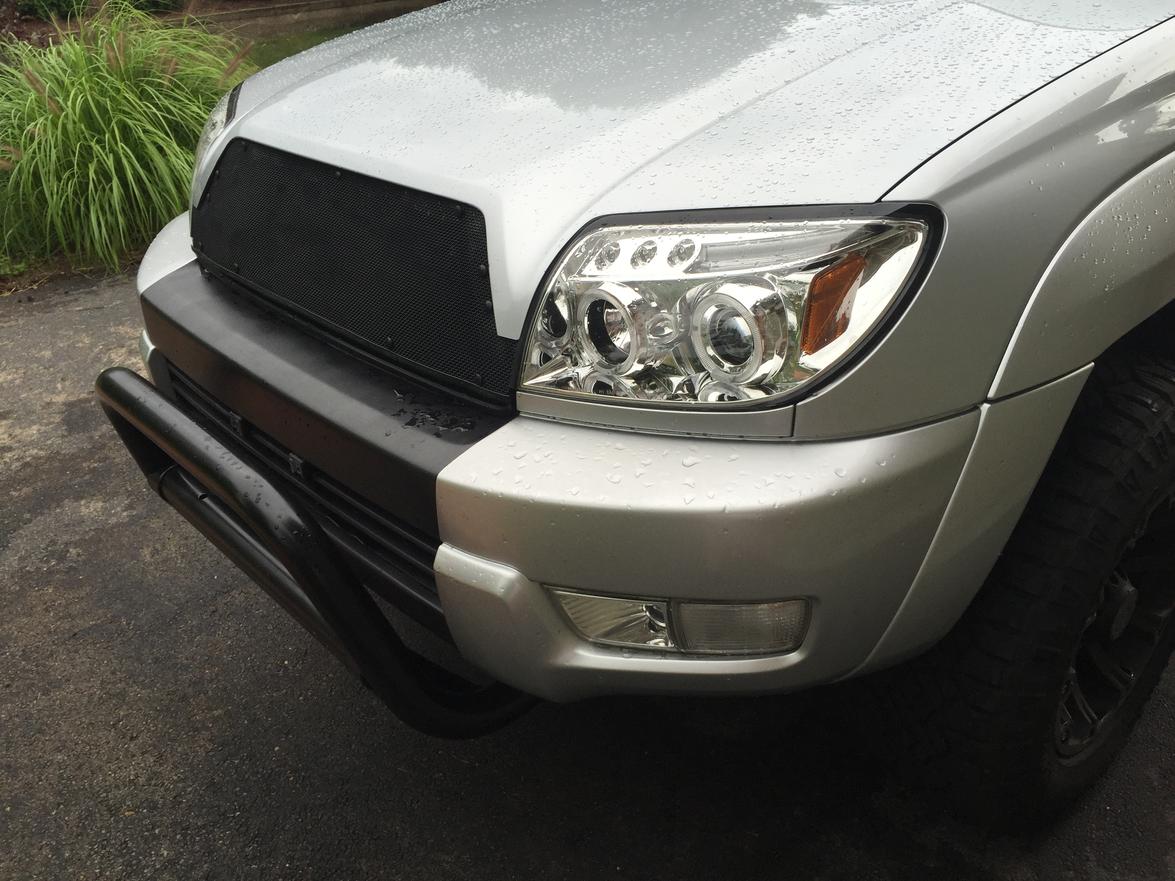

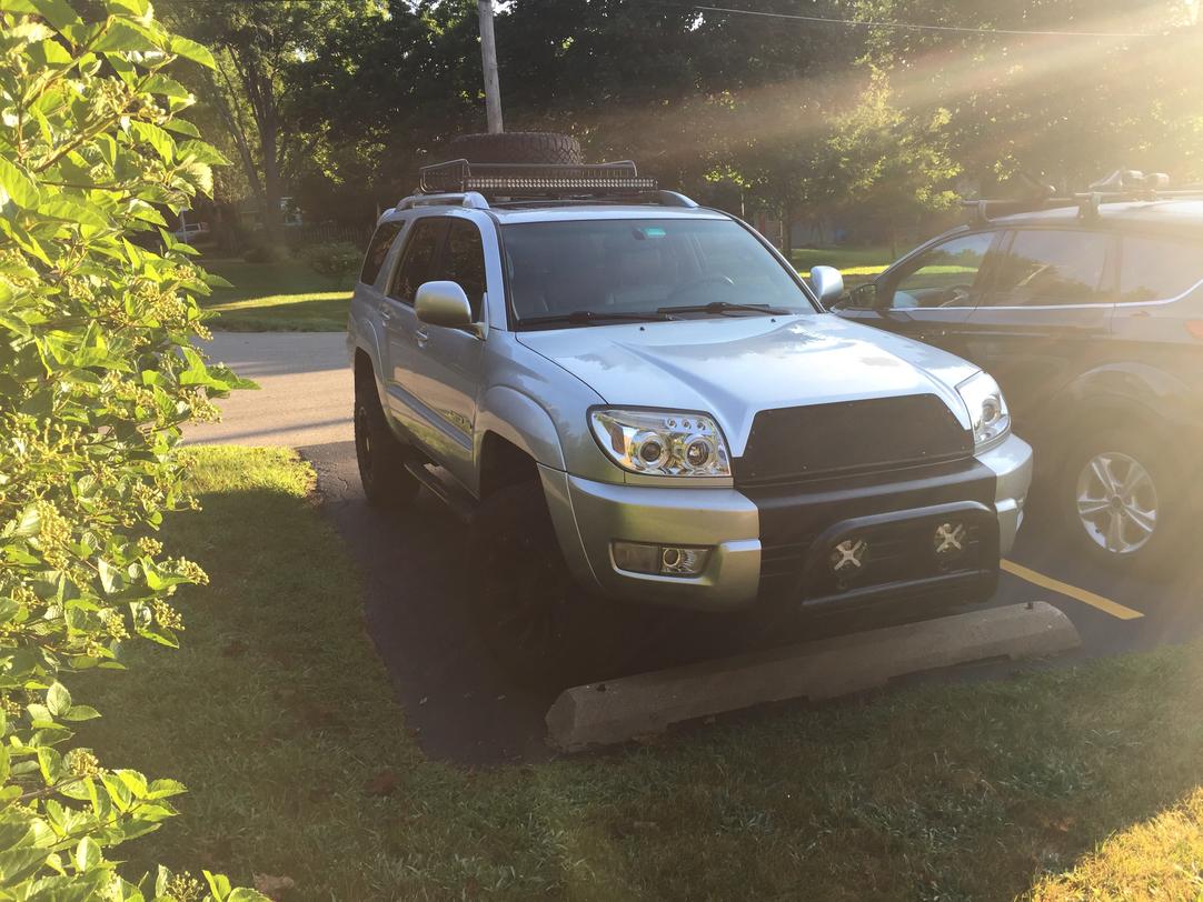

I went in a little bit of a different direction and made a whole new grill from scratch. It still needs some tweaking but I think it looks half way decent for using all free material I scrounged up. Still deciding if I want to put a Toyota logo across the front.
Sorry for the crappy picture quality...

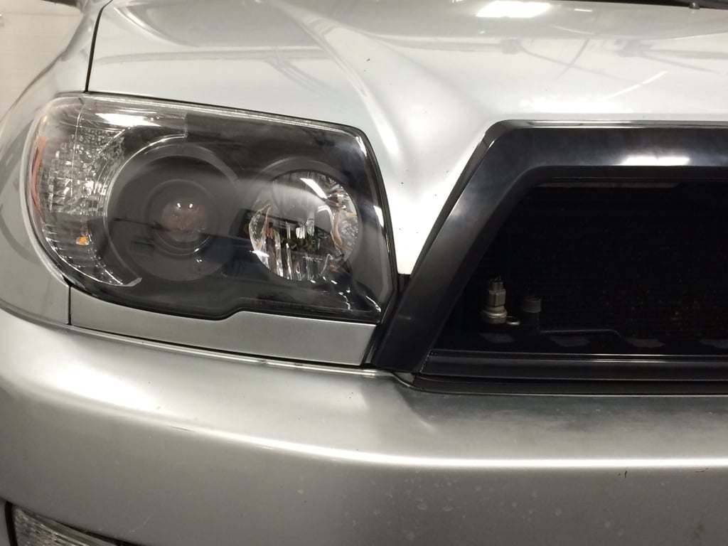

I was torn between keeping the oe headlights and trimming the grille to fit, and doing the facelift. I really don't like the look of projector style headlights especially retrofits. The increased light output over my stockers is what made me decide to go this route. I thought it made for more of a completed look too.

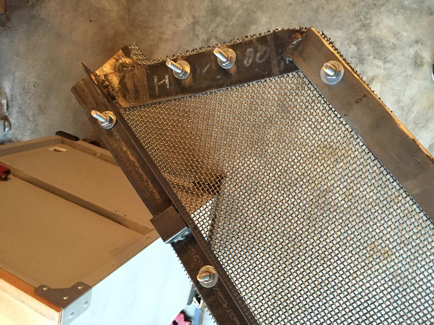

Can you please explain? Looks very cool, but how do you fix the mesh to existing location without the frame?

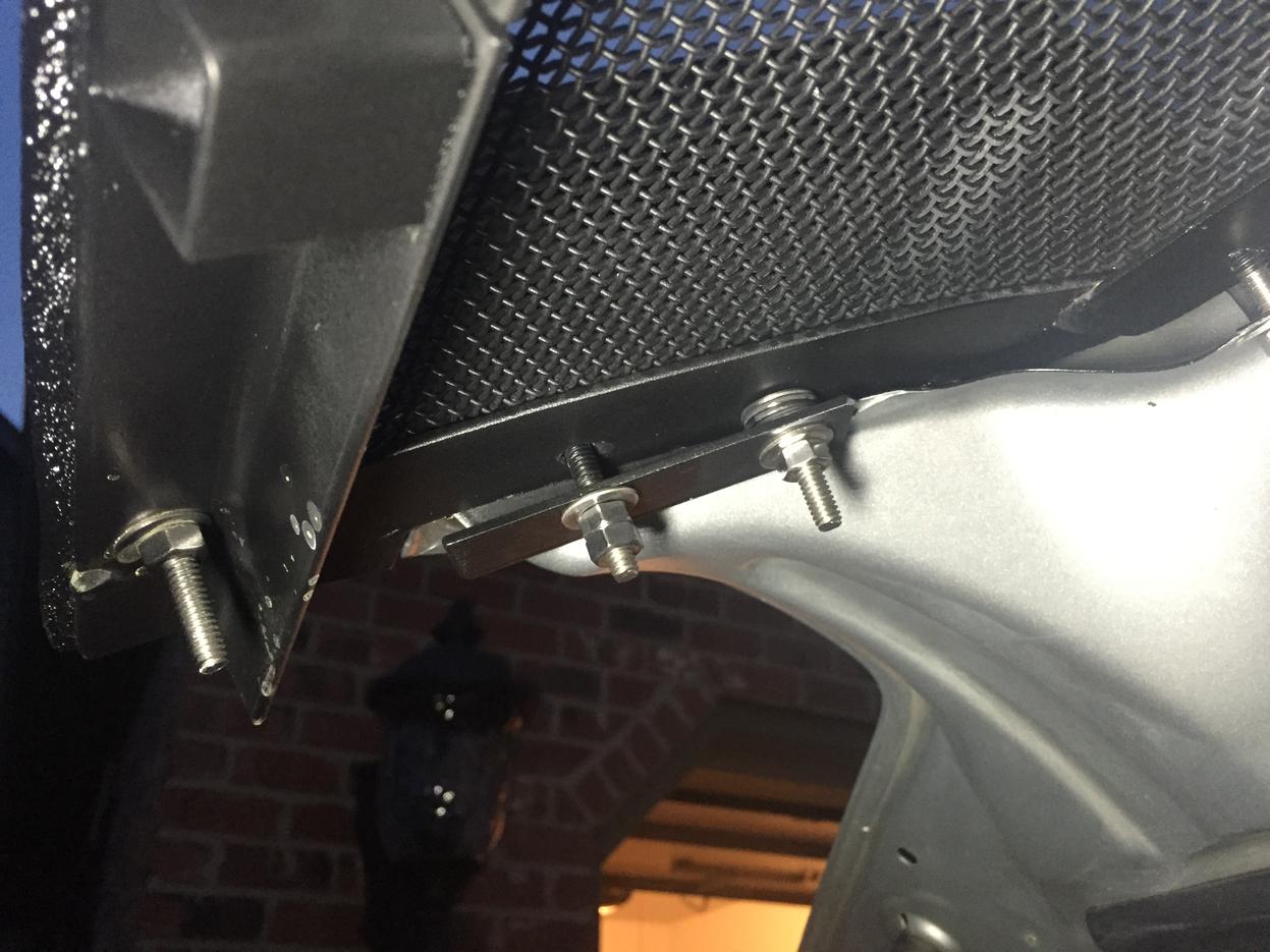

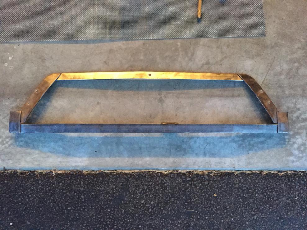

Thanks. I ended up building my own frame from angle iron and flat stock I got from work and used stainless steel mesh from a friend.

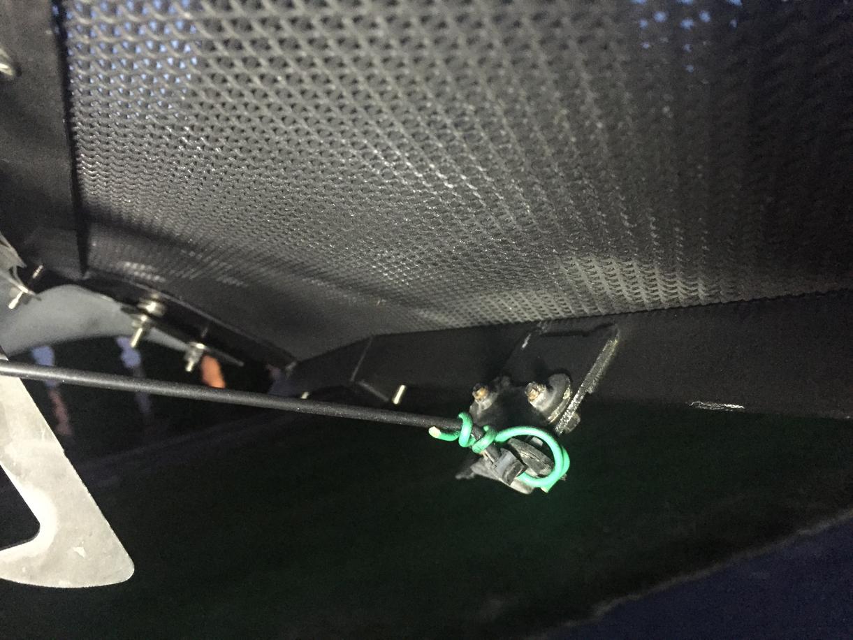

The bottom piece is angle iron with a tab welded to it to bolt the hood latch to. Photo Aug 13, 8 14 12 PM.jpg
The rest is flat stock. The frame and screen are bolted together and connect to 6 of the original bolt locations. I had to make plates for the side bolts to reinforce the mounting points. I'm still in the process of making some nice aluminium spacers to replace the stack of washers that are there now. I also need to fix the hood latch mechanism since the hood closed on it and crushed it while I was trying to line up the bolts holes.
