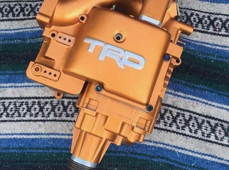

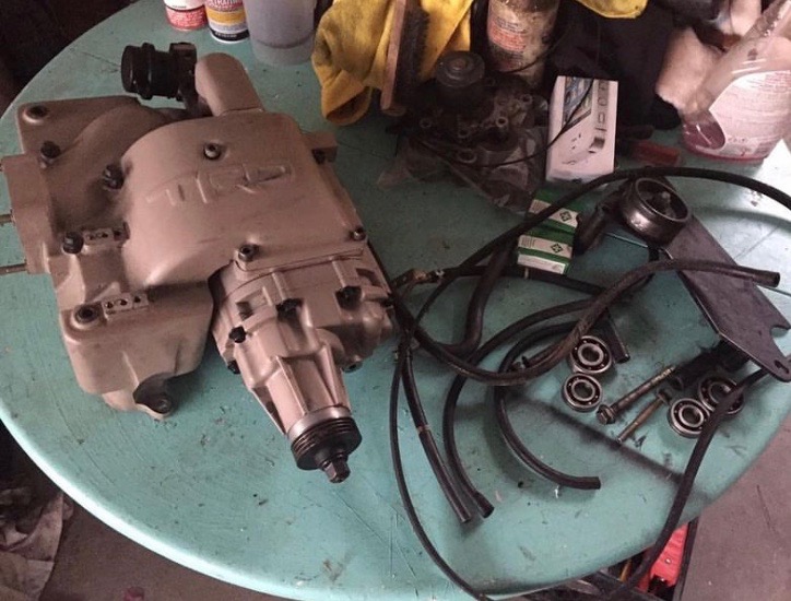

Here are some pics of the sc I plan to buy from him:
After painting:

I'd have him send you better pics of the parts spread out. That way you can confirm that every part is there needed for installation. You can find a list of the parts needed here:
http://www.lcengineering.com/LCInstructions/89-89-34-003_Rev1_Toyota_34_Magnuson.pdf
I'd also consider getting a dynamic tensioner. That one is using the old static version. And also plan on getting new belts.
The more you post the less of a great deal this is becoming. I agree on ditching the static tensioner, it's not sold anymore for a reason.
I also see the bearings on the left side, did he purchase all the bearings ahead of time and them have it rebuilt? Normally you let the shop use theirs than provide the parts.
