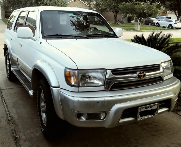

So, purchased a 2001 4Runner Limited RWD 228K Miles about a week ago for $2200.
Did the usual checks, VIN Audit etc but did not take it to auto shop for a checkup :wow:
When i met the seller there were 3 people behind me so i felt a bit pressured and may have made a rash decision...
Anyway, decided to take it to auto shop on my way home after picking it up and thats where i got a few surprises:
1) Alternator was bad
2) New plugs and filters
3) New rear axle bearings and seals
4) New belts
All about $800
(Just replaced Alternator)
Should i spend the money and hope nothing else fails.
Or Try and sell as is and hope to recoup my investment.
Your Input Is Appreciated...

That's a loaded question!
First things first, how does it Run? Bad? Is that why they suggest plugs/wires or just CUZ?
Is the alternator light on dash ON? Is that why the new alt or Cuz a reading shows low output voltage/amps? Rebuild instead?
Are the rear seals leaking? Easy to tell.
You should be able to tell if the belts need replacing, do they?
All in all, 800 is pretty good for all that, usually the rear seals are that alone or more.
Without knowing how it runs otherwise (meaning any smoke from exhaust?), how the exterior and interior look (do they need to be re-done too?), it's tough to suggest what to do. But 800 ain't much more to sink....so Go for it!
Luck and enjoy that Runner. :cowboy:
