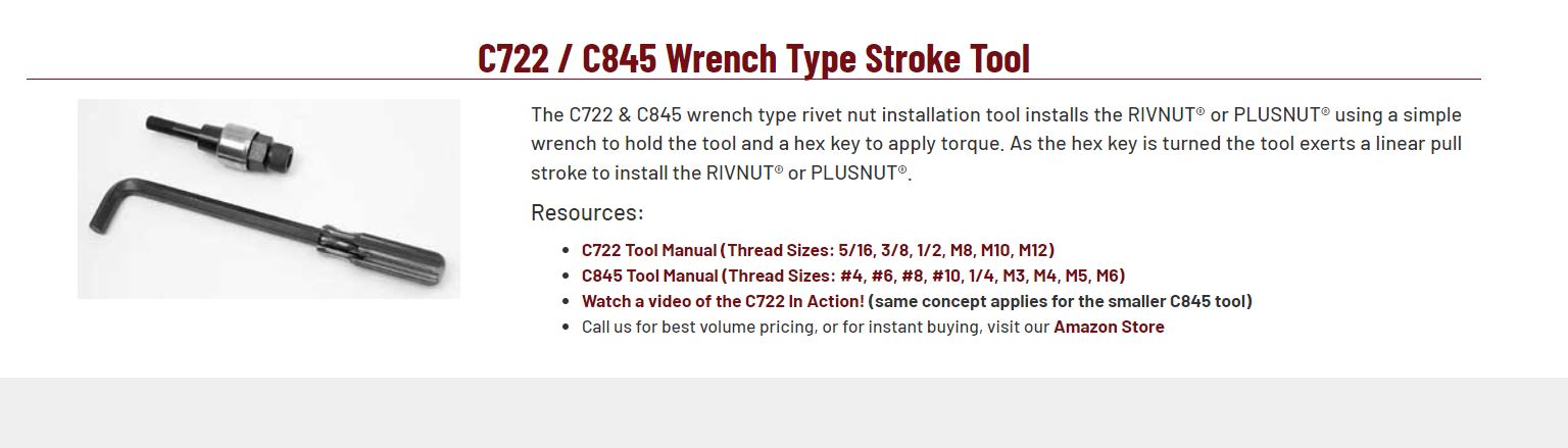

Rivnuts are a great option if space is too tight for a regular hex nut. I've used them for adding a second fuel tank on my Landcruiser. Please use actual Rivnuts and not nutserts.
I used the tool below for my 3/8" x 16 Rivnuts and here's the link below: C722 / C845
Rivet Nut Tool | Rivnut(R) Installation Tool | Rivnut(R) Tool | Rivnut Hand Install Tool | Rivet Nut Installation Tools
Pic below
I wouldn't use these types of nutserts because they may not heavy duty enough but I've used on other applications.
