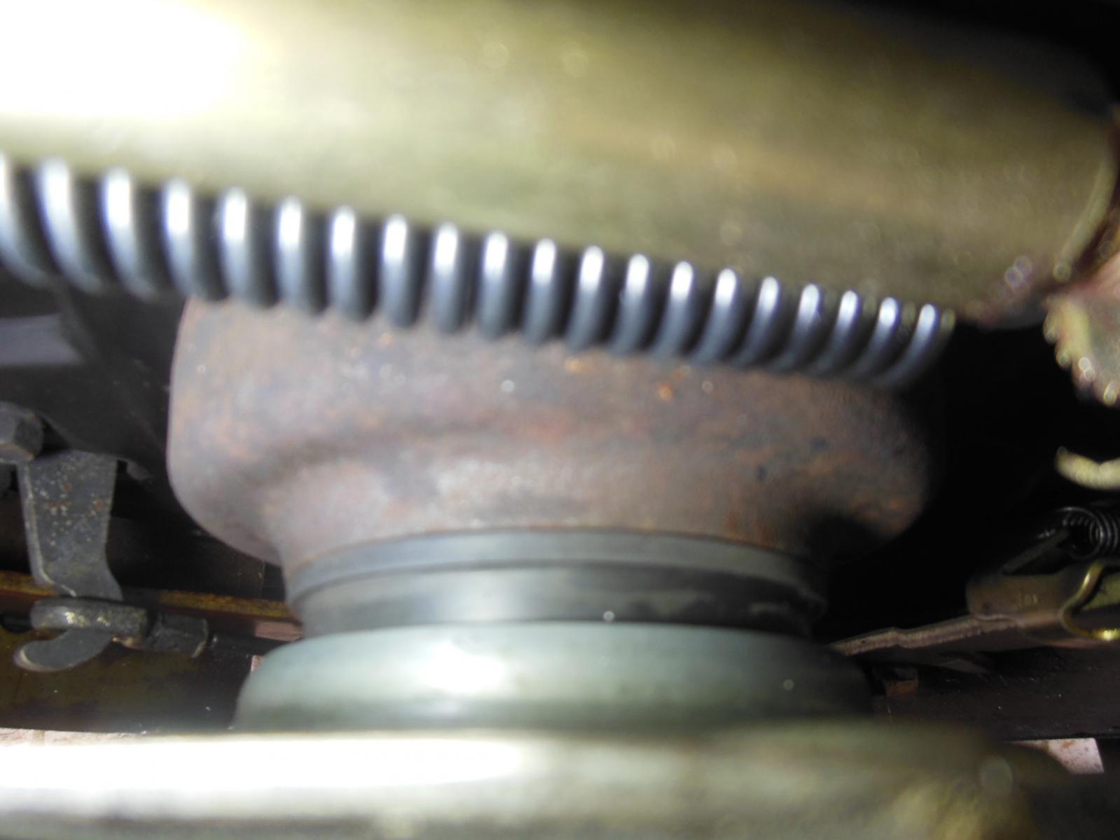

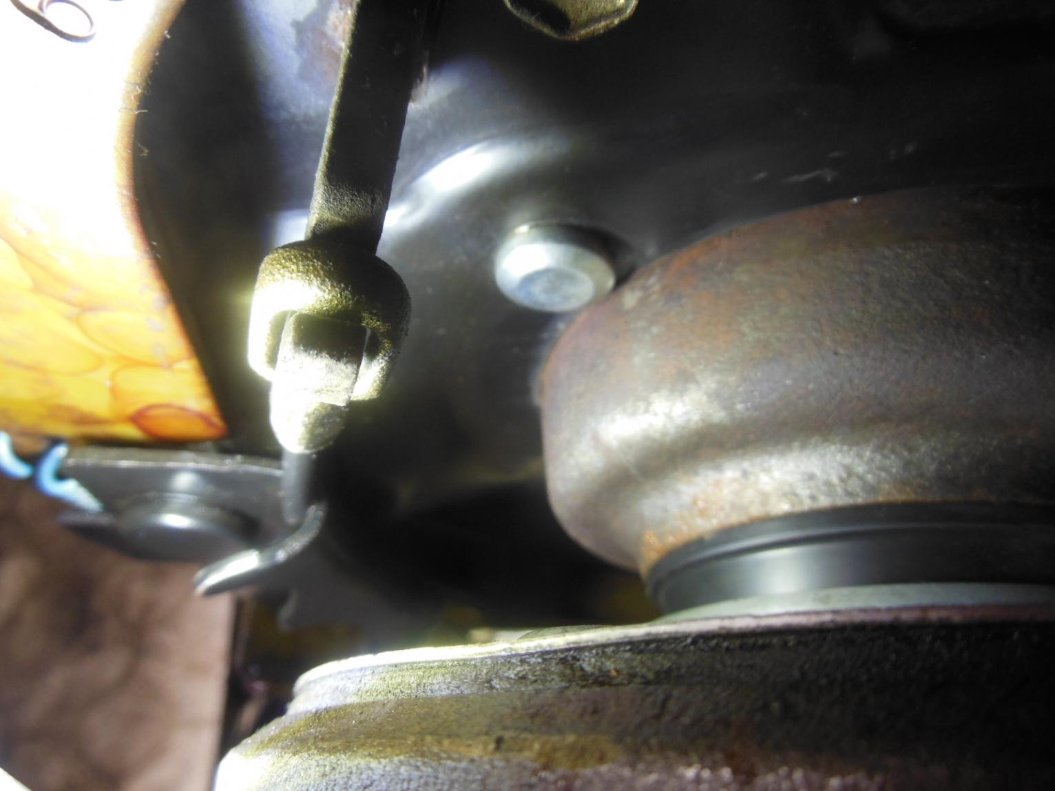

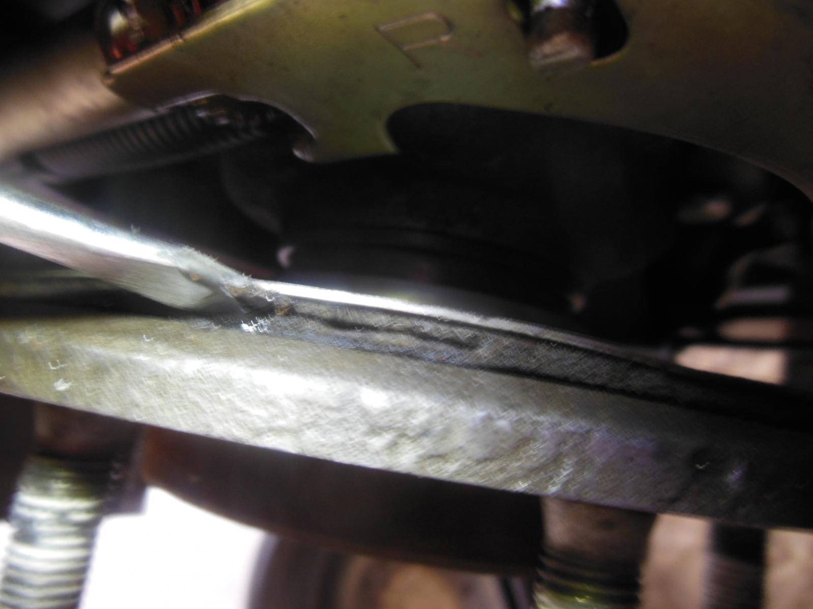

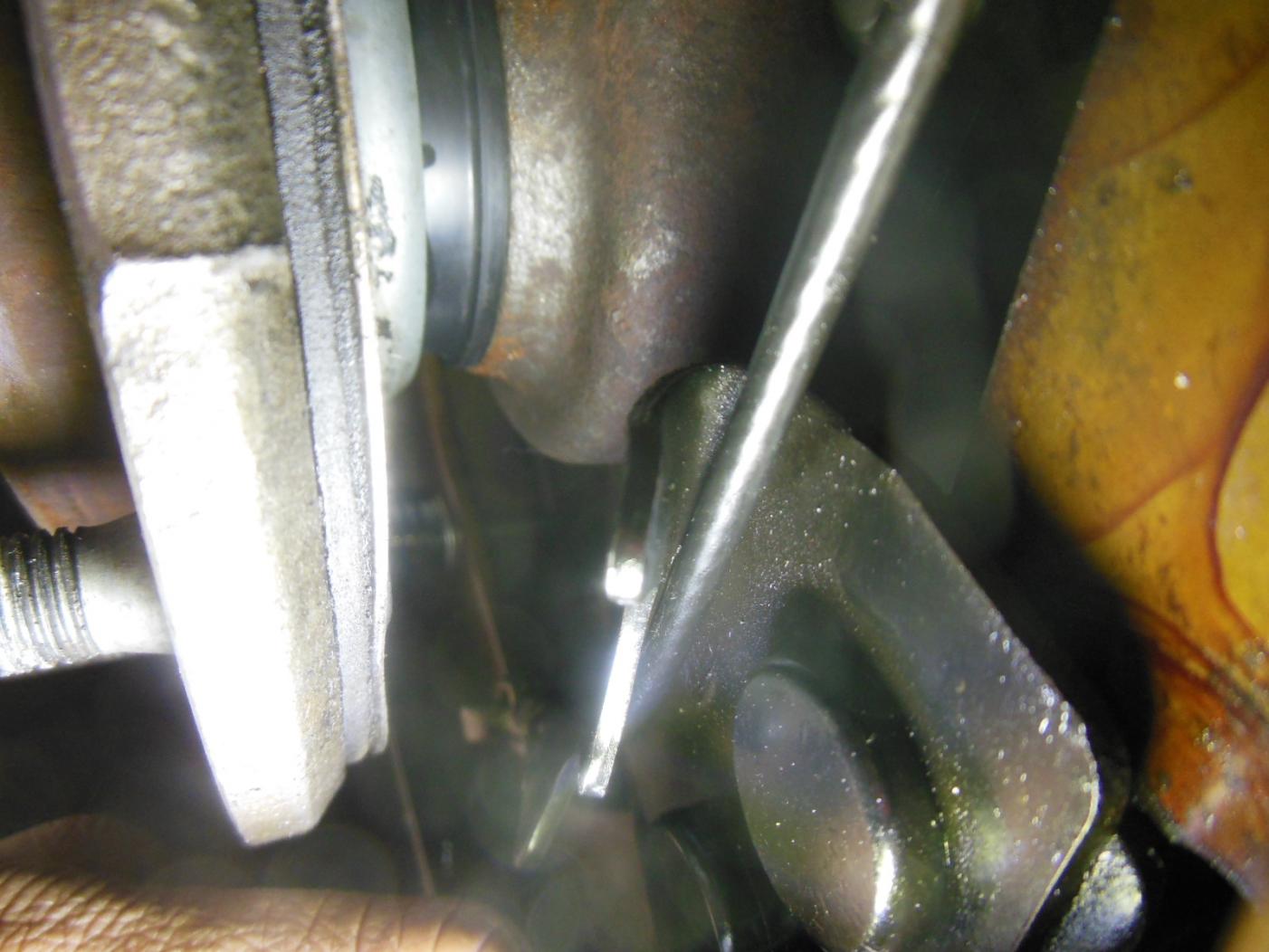

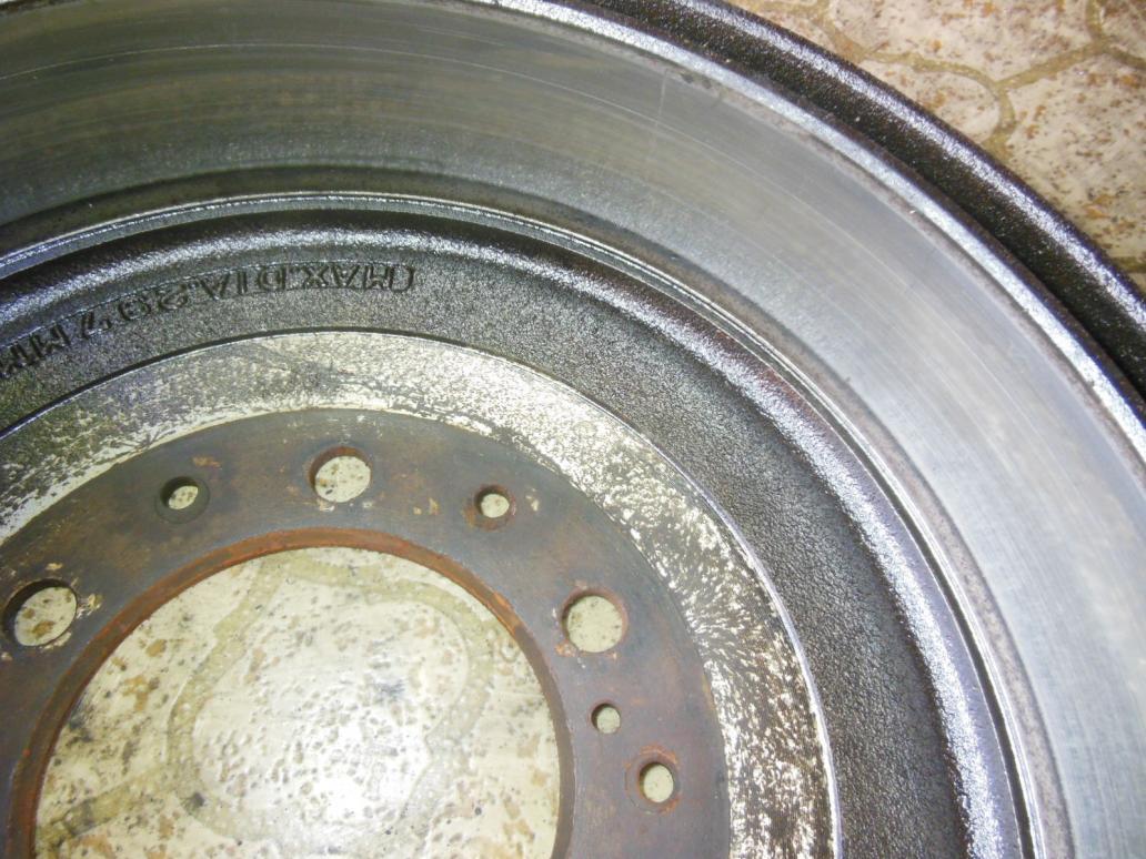

Clean the felt on the back side of the hub:
Look at the images: I did the rear axle oil seal about 4 years ago and got new OEM seals and shoes.
DID NOT saw the felt on the back side of axle hub (last image) has absorbed oil and it started throwing the oil it absorbed all over the drum and new brake shoes. At least that is what I think? No sign of oil leaks as evident by the images:
What do you think?

The rubber seal that is pressed into the front side of the bearing case is there to direct any gear oil getting past the bearing into the metal piece behind the axle face. From there, it will go out a hole on the axle face and end up in the drum. I wasn't the one that discovered this but somebody on this forum came up with this theory and it makes sense. I guess it buys you some time before the brakes get coated in gear oil? I thought at first that the rubber seal was just some sort of dust seal to keep brake dust from getting to the bearing but then why would the face of the axle have that hole in it?
So, that cavity behind the axle face could store gear oil in it and it would be prudent to get in there with some rags and brake cleaner to clean out the residual gear oil in there. We're probably not talking a whole lot left in there but that's what you're probably experiencing.
Is there any chance your breather might be plugged?
Given the safety implications of having gear oil all over the driven wheels I am stunned that Toyota never stepped in and fixed this issue.
Once the shoes get soaked, I am pretty sure they are toast, its worth cleaning them with break cleaner but you probably need to do new axle seals and break shoes.
