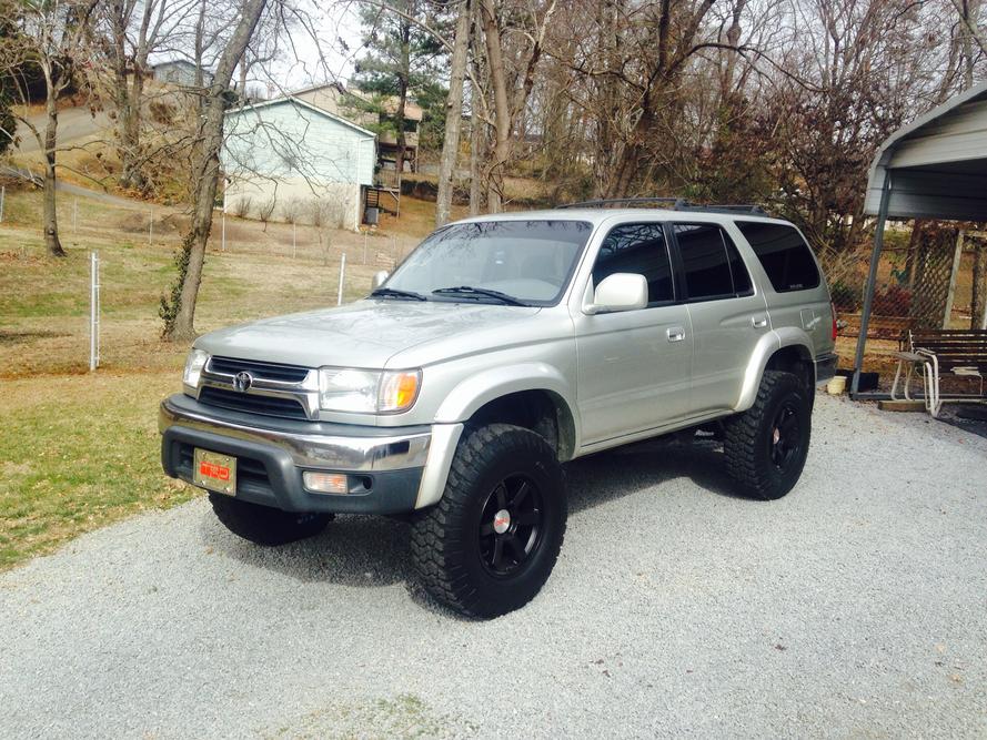

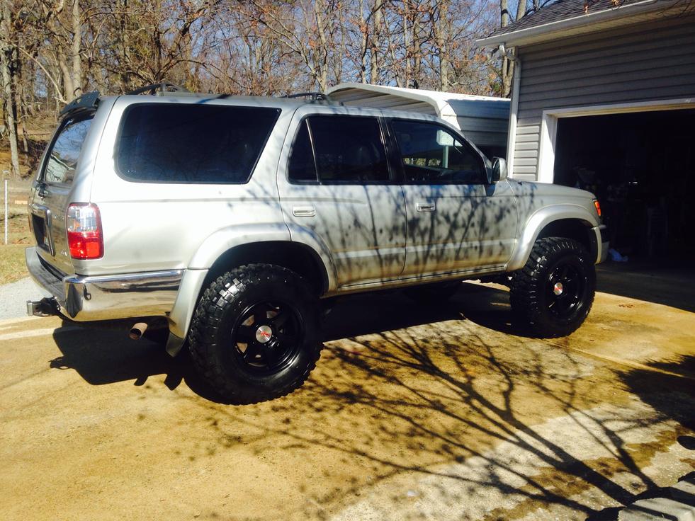

I have installed the toytec ultimate lift with 891's in the rear. I'm setting a little low in the rear. I don't want to adjust the front down because my 255/80R17 BFG KM2's are close enough as it is. Any opinions out there on what brand of spacer lift to go with. I plan on going with at least a 1.5" spacer. Most that I see will require the removal of the cone bump so that will take another 1/4 to 3/8 of an inch from my height. So the 1.5 spacer will prob only give me a little over an inch. Any suggestions on which brand to go with?

Fine truck!! Silver is close to my heart. Sell those springs and get some LC springs perhaps? Get some positive rake possibly depending on which ones you get.
i have a bunch of rake with LC 9 wraps... I'm sure LC 8 wraps would give you a little rake and LC 7/7.5's would make it even...
i have pretty much your same lift but with 9 wrap coils in rear
