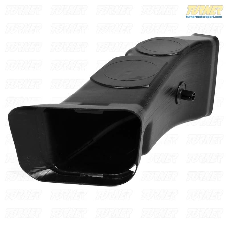

I also mod a BMW brake air duct from those holes in the bumper to direct more air flow to the cooler :banana:

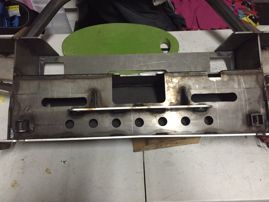

I have the exact same bumper on my 2nd gen. (Which has a SC'd 3.4 stuffed into it) and I was pretty concerned with airflow. I emailed the builder and was assured it has never been an issue... I don't know how much field research was done or whatever but that's the response. I still wanted to have piece of mind so I added a bunch of specific holes to the rear plate of the bumper to match 1) the holes in the very front of the frame crossmember and 2) the gaps between that piece and the one above it where the stock grille would have been open.
7 1" holes on the bottom and 2 1"X 4" slots above those.
I still have noticed a little more activity on my temp gauge but nothing in overly concerned with. And I've gone up some good hills in 80-90 degree heat. Mines also a manual so this entire post may be irrelevant
