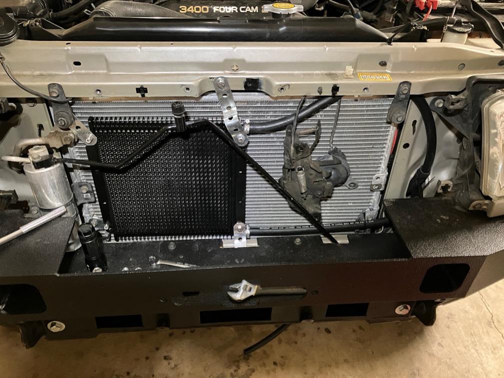

Out of curiosity, why did you size your bracket to fit the 698 cooler rather than the larger 699 model? It looks like both would fit and as long as it was one of the thermal bypass models, wouldn't bigger=better?
The 698 size is what I originally installed on my personal FJ years ago. Its now on 39" tires with all the armor and weighs almost 6000 lbs, seems to still cool adequately.
I agree you can never have too much cooling capacity and if it were up to me every Toyota would have an aux cooler installed, a 698 is vastly better than no cooler at all.
The other reason is the 698 size is alot easier to make bolt-on brackets for.

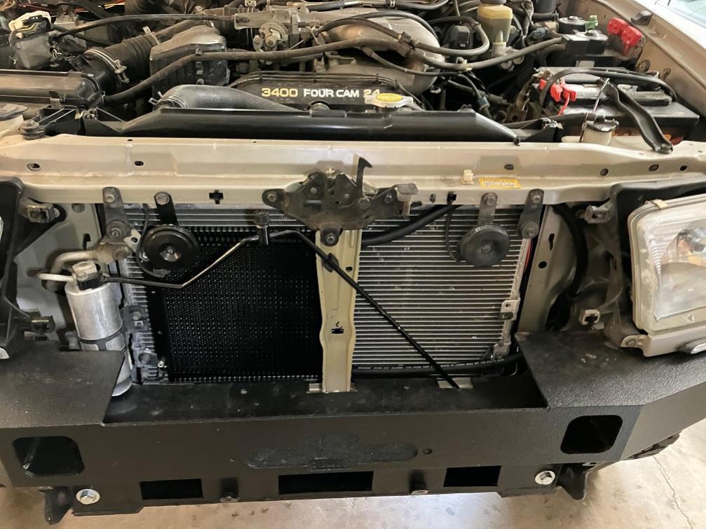

I have the same bumper, but don't have the issues OP is having. I have the koyo all aluminum radiator. Though I did put a massive trans cooler in along with a heatsink type p/s cooler too. Also used foam tape to seal up the fan shroud, a/c condenser, trans cooler. So any air the fan/driving air is forced through the cooling stack. Also I did replace the ac condenser as the oem one was so corroded and plugged (air passages). It's a massively tight squeeze for the trans cooler. Had to make a custom ac line.

Oh man, I wish I'd seen your setup before I had the bumper cut to make room for the OEM hood latch support. I was thinking about doing something like yours but I couldn't see a way to make it fit. Good to know that there is a way to support the hood latch and still fit a winch.
And speaking of, great job getting that thick mishimoto cooler to fit! Seems that everyone else with our bumper can barely get a 0.75" thick cooler to fit with a winch sharing that space.

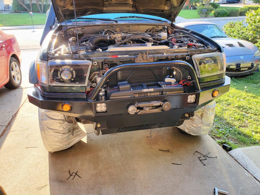

Oh man, I had the same kind of trouble getting my bumper sorted. I also have a 1" body lift so I selected that option when ordering but there was still a very large gap once the bumper was welded. Thankfully my welder came up with a way to raise the bumper up a bit by adding in some material at the bottom. You can see the weld lines on the pic I posted on the previous page of this thread.
Since I had such high transmission temps, I also took the bumper back and asked him to cut some holes in the back plate for better ventilation (also in that pic)

Yep I can feel you with the bumper build. I ended up using some slip on trim to fill the gap and welded a 1/2 inch tall metal piece you can see it in the 2nd pic. I use a scan gauge for trans temp, but now have a stand alone gauge for temp and oil pressure. It gets its (oem) measurements from the outlet of the trans, so it's the hottest oil measurement.

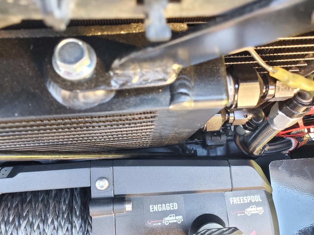

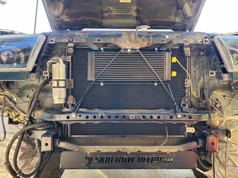

So I finally got the trans cooler installed. I managed to get the larger Hayden 699 to fit which was a bit of a challenge since I wanted to leave as much room for a winch as possible and not use the hood latch support brace as an attachment point for any of the brackets (since that would have to be removed to fit a winch). I used foam tape as suggested above and I'm pretty happy with how it all turned out. Now I just need to wait for warmer weather to see how much of an overall improvement it'll make.
Thanks again to everyone who shared their thoughts on this thread :thanks:

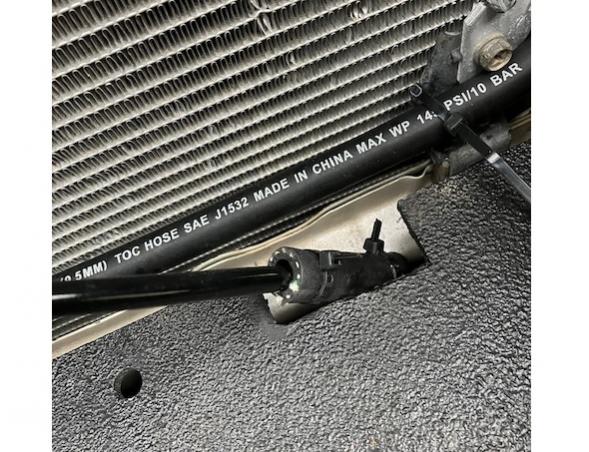

Was looking at pic you really should clearance the cutout around freon line or bend line.
Condenser flex's with body bumper rigid with frame it will rub a hole in the line.
I know it's been a while but thanks for pointing that out. After reinstalling the hood latch support bracket, the freon line had more clearance and I added some hose around that part of the line to act as a buffer for any chafing/rubbing.
