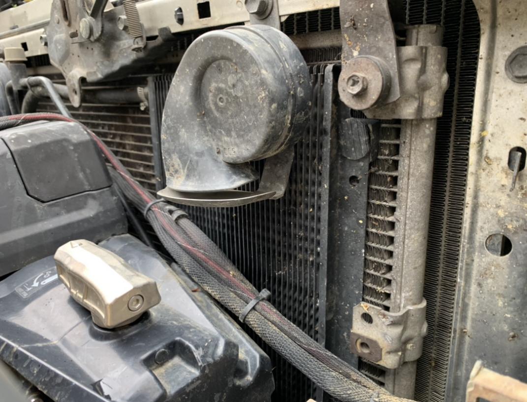

I custom mounted my cooler - it sits behind everything, right next to the AC condenser so the fan pulls as much air through it as possible. Modified the upper and lower condenser mounts, etc. I also used a thermostat on the cooling system to minimize overcooling in the winter. There's now a winch control box in there, and it all still fits...

Oh wow, I really like how your cooler is shorter but goes all the way across. Can you tell me what kind of cooler that is?
Also, I assume you do not have a Coastal Offroad bumper? It seems like it will be a very tight fit to get both a cooler and a winch to fit in mine.

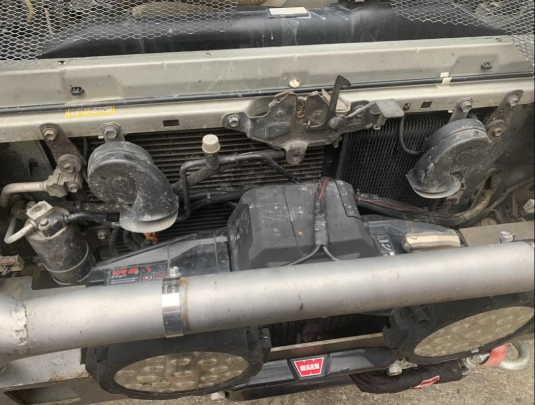

It'll go but it's a fight. I've got a lot of snakeskin and cut up fuel hose in there to prevent chafing.

Trucool LPD4921 (I got the kit with the thermostat). Thinner, more open fins and large frontal area than most trans cooler options. With some work, it fits behind the hood latch support, as you can see. If a winch will fit in front of the vertical support, it will fit with the cooler like that.
My bumper is from Shrockworks. More open on the front than yours and my lower skid plate has some holes to feed the bottom of the radiator too. There's a winch in there now too, but I don't have any current pictures of that setup.
Oh dang, that is a tight fit. I wonder if another winch might be smaller and fit a bit easier? Although, with how much of the radiator it blocks, maybe I should forgo mounting a winch in the bumper...

Nice! I'm glad to hear it can be made to fit behind the hood latch support. Mine is currently removed to fit the bumper but I'm thinking about having a notch cut in the bumper to allow space for it to be added back in (the hood latch feels pretty unstable without it). Unfortunately, the support would have to be removed again to fit a winch but maybe I should forgo a winch considering how much airflow it'll block...
Oh man, that's a really tight fit! I see you used the zip-tie method to attach the transmission cooler. I was hoping to figure out some kind of bracket solution but it looks like there's just not enough room with the Coastal Offroad bumper (if I want to do a winch).
Was it the wires on your winch that caused the clearance issues?
And the trans cooler lines and the winch itself and the AC condenser and the....
It's 10lbs of crap in a 5lbs bag. I actually had to move the trans cooler to the other side of the condenser/radiator when I got my winch because they were trying to occupy the same space.
Haha, that's what I'm realizing as I try to plan out how to get it all in there. Thanks for the heads-up about the ATC needing to be on the drivers side. I'll keep that in mind if I go with one of the more square shaped coolers.

For the record, I’ve never had the zip method fail me. Even on a condenser with half rotted fins. It was the only way to reasonably mount the 4589 I put in the 97 Limited Puppy Hauler.

Get a 3/4" or thinner cooler, mount things carefully and you'll have room.
Oh, and don't think about using a narrow 'race' winch - you'll need one with 4.5"x10" mounting foot dimensions.
