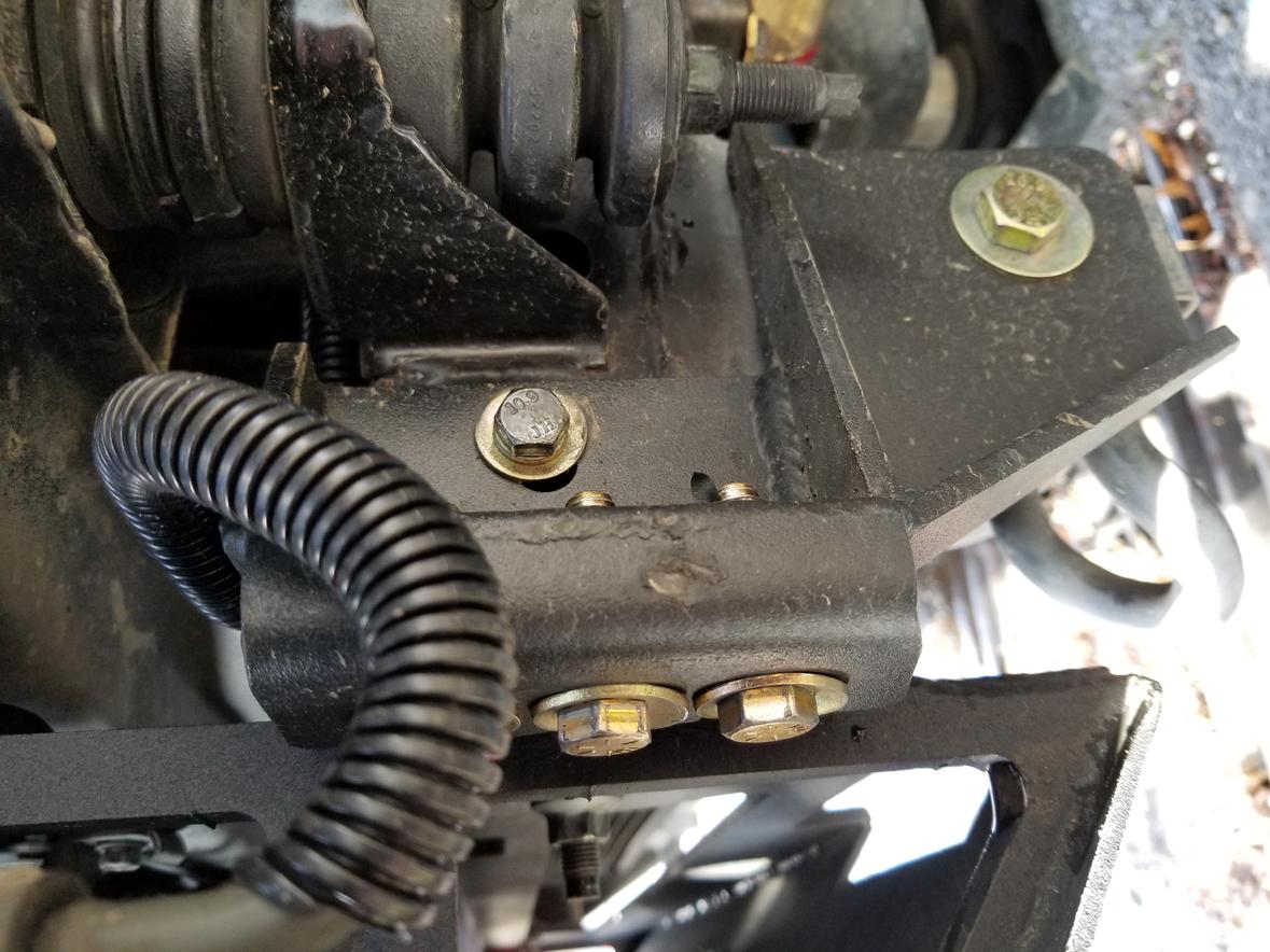

My Demello came with a bracket that re enforces it. Pretty thick. Bolts on. It basically sandwiches the mount between it.
I ordered a pelfreybilt and yesterday I was looking at my buddy’s taco that just recently installed a pelfreybilt. He told me the flange is very thin and he was going to reinforce the flange. So I’m thinking I will probably have the same problem.
20180325_110848.jpgBracket that comes with Demello.
I thought that plate was a bit thin when I built my DIY winch plate. I secured my mount to the 3 bolts on the outside of each and that's it unfortunately. So far so good. In hindsight I wish it extended down to engage the threaded holes in the side of the frame member.
