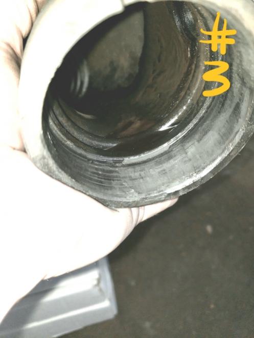

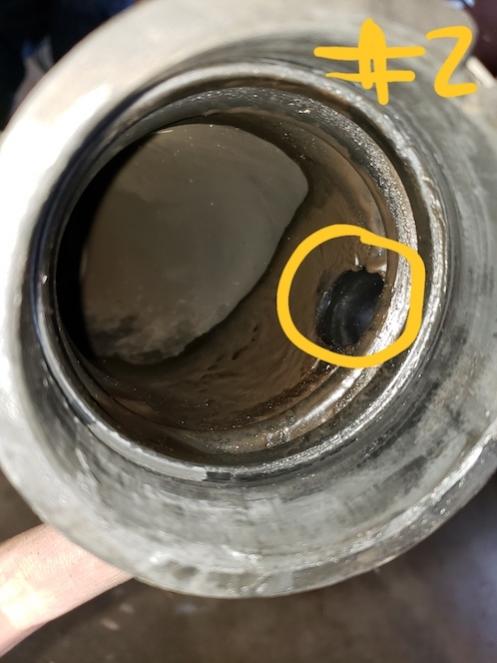

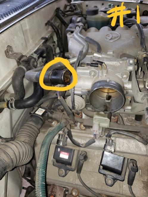

So, I was in the process of getting to my throttle body, and noticed what seems to be oil around one of the vacuum hoses connected to the port on the air hose closes to the throttle body (see picture #1 & #2). There was also oil build up inside the opening of the air hose closest to the throttle body (picture #3).
What would cause this?

That is the fresh air vent for the PCV system.
If you have oil there you got more blow by than your PCV valve can take away at higher throttle settings when vacuum is low.
Either way it’s pushing up under pressure from the drivers side valve cover.
Ill be replacing the pcv next week, is that the remedy?
