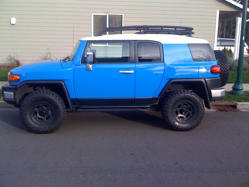

I have a buddy with a limited ALL black FJ with the black rims and they are SWEET. I NEED to get me some of these rims when i get my 4R

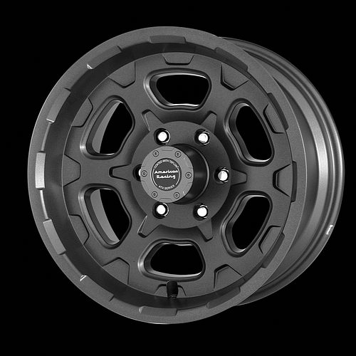

A pic of the ATX Black Teflon Chambers
