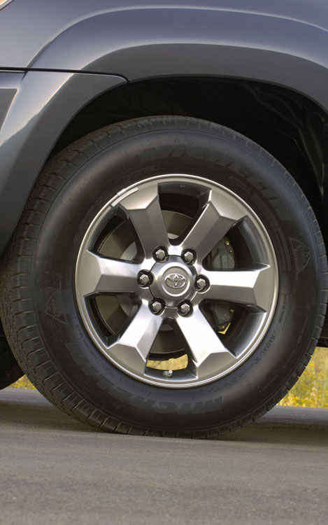

has anyone put 18 inch wheels from 4th gen on yet. I kinda like this style wheel, but its got 25 mm offset. anyone know if this is compatible with 2010 with 275 profile tires?

I would have to know the backspacing on the wheels and the rim width. It looks like it came off a 4th Gen Limited or Lexus GX470 were close to the same, so it should fit.
A 275/65/18 would work as it's a 32.1 inch tire.
A 275/70/18 is a 33.15 inch tire......way too big with stock suspension.
The biggest problem I found with 18 inch tires is they are alot more expensive compared to the same tire in 17 and you don't have as many choices as 17 inch.
I would have to know the backspacing on the wheels and the rim width. It looks like it came off a 4th Gen Limited or Lexus GX470 though so it should fit.

size of rim is 18x7.5. interestingly this is size on new lexus gx460 and that rim looks just like the 4th gen 18 inch rims.
i would be putting 275/65/18 size.

Oh yea, that would look great and fit perfect.

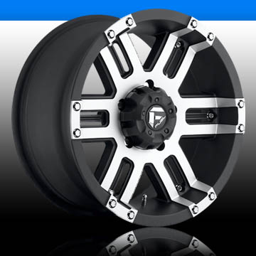

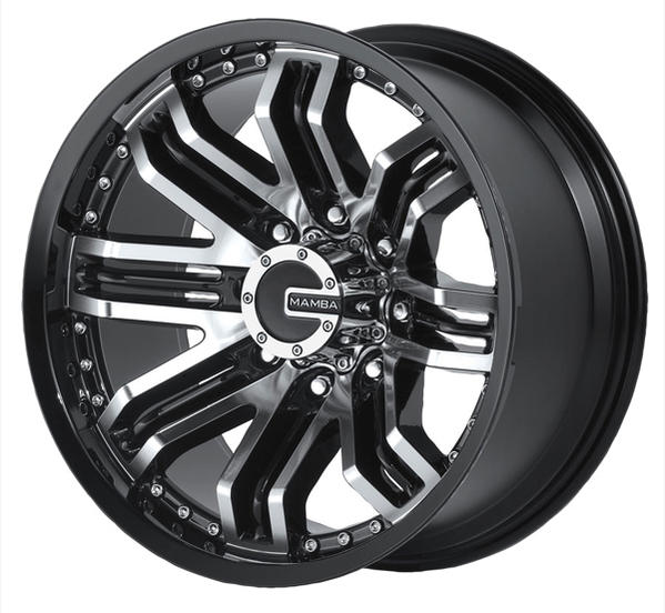

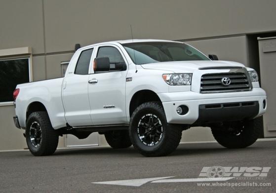

what do guys think of these wheels for a blizzard limited. want 18 inch rims. 20s very limited tire sizes. need something looks similar to stock.
1st
mamba m3
Size: 18 x 9
Bolt Circle:6x5.50 (139.70)
Offset: -6mm
Backspace: 4 3/4
2nd one is fuel Gauge D501
Bolt Circle: 6x5.50 (127.00) ?not sure if this would fit with 127?
Offset: -12mm
Backspace: 4.50"
This is a Killer...not sure if they fit the 4runners tho'...but if so...I will be getting a set for my 4th gen.... I am trying to get 20" but dont get the option for this model unless I keep stock size 17" dunno why?....I need to call the seller to verify tho'
