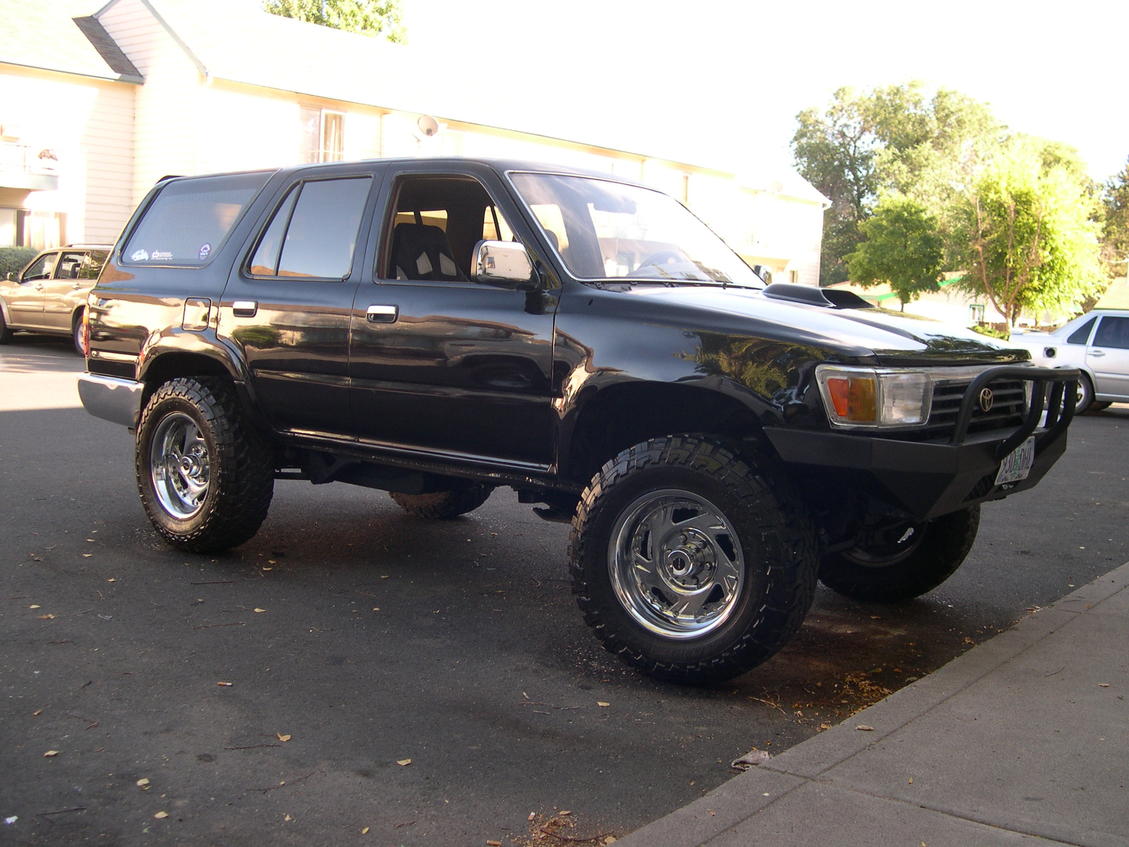

The paint also looks awesome after final cut and buff..changes three different colors in the sun...not that that makes it run any better...but?

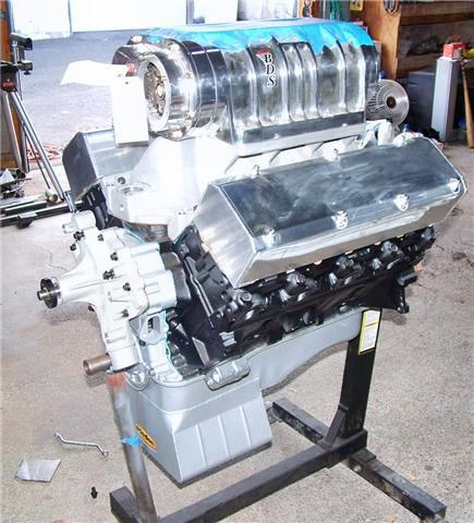

My goal is an efficient form of transportation in the snow...I build plenty of engines with horsepower / torque as the goal (see pic of my latest), so if I want to talk sh*t...it would be on a different forum.
Sorry if I've upset anyone, it wasn't the goal...I just simply wanted to know what the best cleaner for the maf sensor was, not start a "prove it" type discussion.
By the way...the pic is of a 8-71 blown, 557 inch Ford with Snow methanol injection for cooling. 1400 hp / 1000 ftlbs torque on pump gas that is in my 33 roadster. (and still gets 15 mpg)
