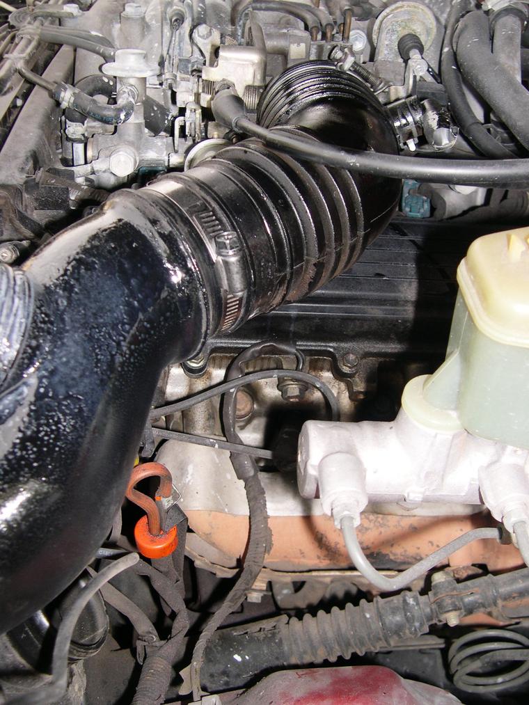

on a side note, how are your running your intake tube, keeping it cold or at least cool? i know you said you kept it shielded from the exhaust manifold but what are you using? did you wrap your exhaust with that header wrap stuff or did you put a shield on your intake tube itself? ive been thinking i should shield my intake some how and when i do headers and a SC, im gonna wrap the headers and maybe put in a set of RunCool hood louvers to help suck the hot air out of the engine bay as well as make the sport hood functional. anyhow if you have some pics of what you have done id love to see how you have streamlined and simplified things as well as improved them
The tube from the airbox to manifold is two piece (accually three with the box looking affair that will be removed). I just removed the heater or "warming" box from the path, hence "cooling" or in reality keeping the air cool. The box thing lays really close to the exhaust manifold and I'm assuming it's Toyotas way of pre-heating the incoming air charge...why, I don't know, but I looked at it as defeating the "cold air" intake. So the solution was a tube/path away from the manifold.
Simple rule of thumb I use, gained from an engineer at BDS superchargers is this...for every 10 degree drop in intake air temp...it's one free horsepower. Without getting into air density/moisture and other issues involved...suffice to say that the colder the incoming air, the better...which is why we use "cold air" kits, intercoolers, etc.
Something to also keep in mind...instead of using header wrap, which will accually damage the manifold/header, consider ceramic coating(s). The initial cost of ceramic may seem expensive, but by the time you buy the wrap, destroy the part, then have to replace it...and then coat it...it's pretty cheap. The theory behind coating (or wraping) an exhaust component, is to keep the air inside the header (or whatever) hot, and therefore easier to move...not so much keeping the air around the component cool (although in a hooded vehicle it's a bonus) Cast iron manifolds are more suseptable to damage than tube headers because of the type of metal (cast versus forged or drawn) The heat contained within the wrap, will burn a certain ammount of the carbon out of the metal, create fatigue, and eventually break.
Anyway...i'll get some photos and let you decide.
Here's a pic of the tube from the airbox to the TB...it isn't pretty, but for a total cost of...oh yea, ZERO...it seems to work so far. When I get concrete data on the change, then mabey one bent from some solid tube...who knows.
All I did was remove the box that pre-heats the incoming air, and route the tube away from laying near the exhaust manifold.

"This box"....yes....this box's description escapes me (and it's true purpose), but as you see, it's not on mine now.
csrobb007 what did you cap the end of the upper hard plastic tube with after you turned it 90 degrees? Also the rubber line going to the drivers side valve cover what did you do with it also?
cap...2.5" cap I get on the ends of tubing I buy for the shop, put a little rtv on the inside and clamp it. Like I said in a previous post...this setup is temporary...I figured I would use what's there to see if any gains were to be had before spending money on tubing, fittings, and the rest of the stuff to do it pretty.
