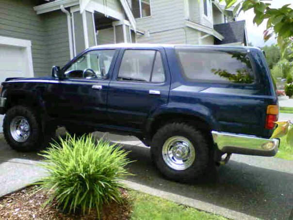

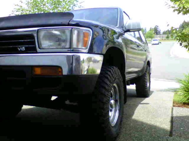

What other questions you have? And how about some pics of Yogi!
Just ask them in this thread and well try to help.
:) I have some pics of Yogi, if I can figure out how to put em up I will..

Ok there hows that?? ;O)
