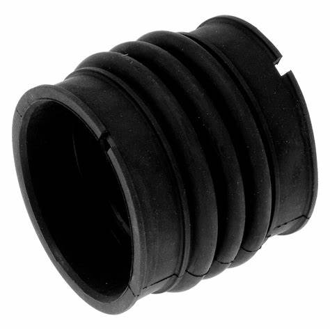

This is close to what I need, what is it called and where can I buy ?

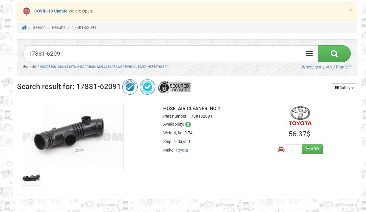

Here is the diagram Olathe Toyota site
Genuine OEM Air Intake Parts for 2000 Toyota 4Runner Limited - Olathe Toyota Parts Center
