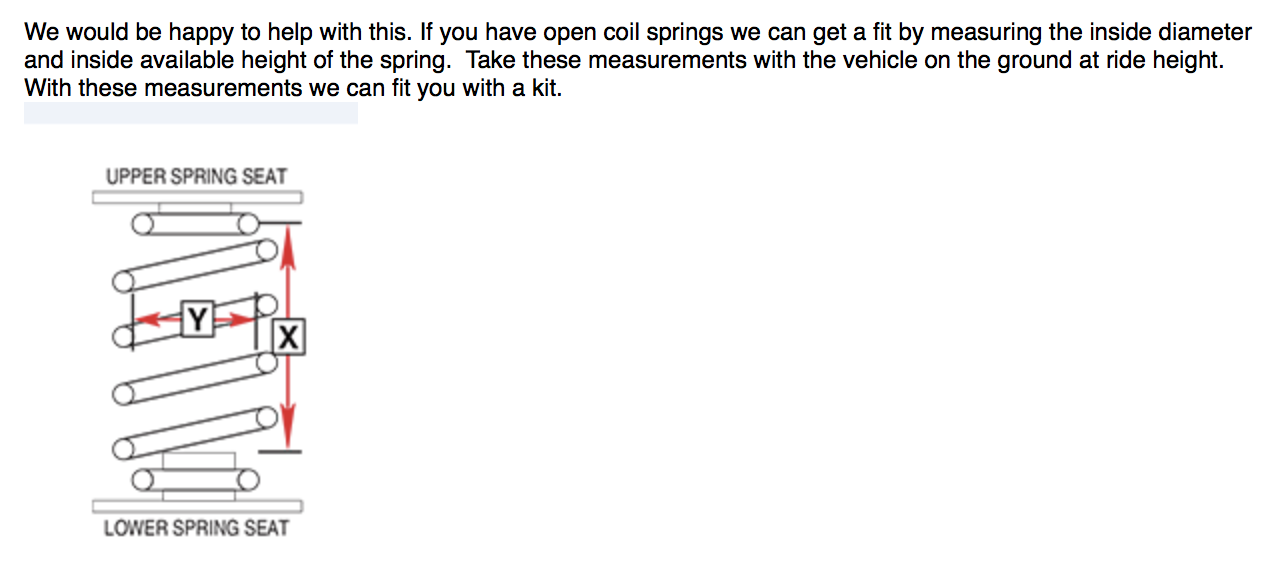

AirLift are really responsive and will sell you an exact size to fit your spring if you email them and have a measurement of your spring.
Here's what they told me:
