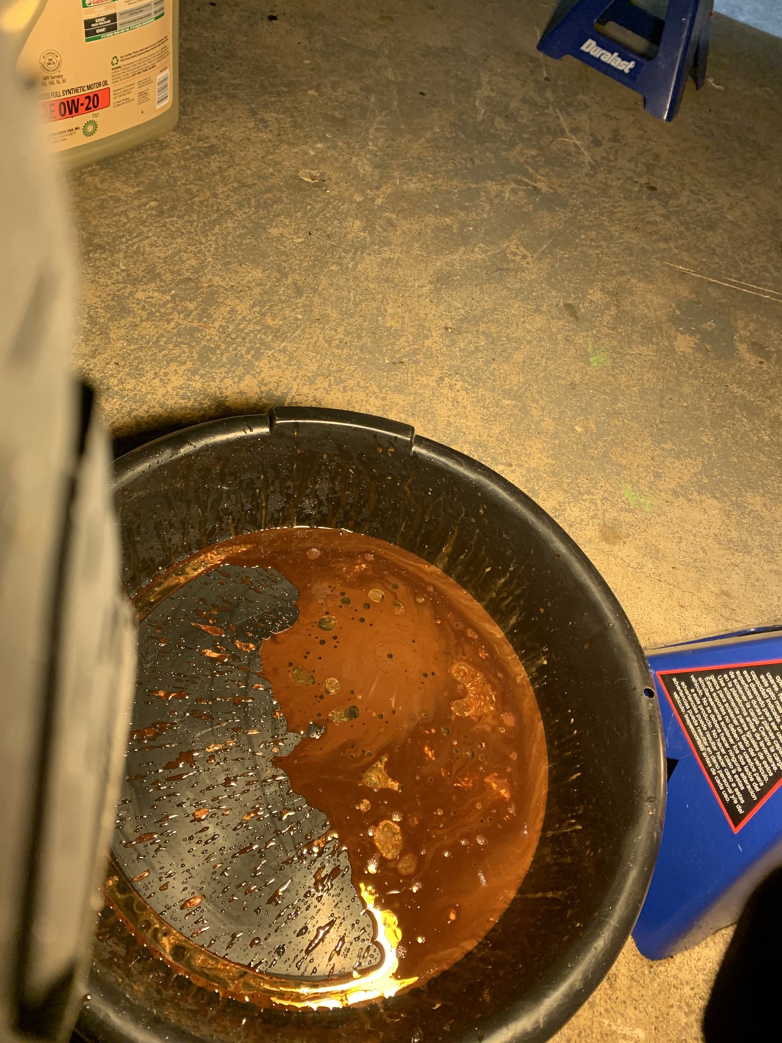

110,000 miles later and still going strong. Did an oil change this weekend because what else is there to do when you're cooped up at home. Drained a 'few ounces of natural lubricant' out of the catch can so it prompted me to update the post. I rather know this isn't going anywhere. Laugh away... now back to relabeling my canned goods shelves with my Dymo label maker.
