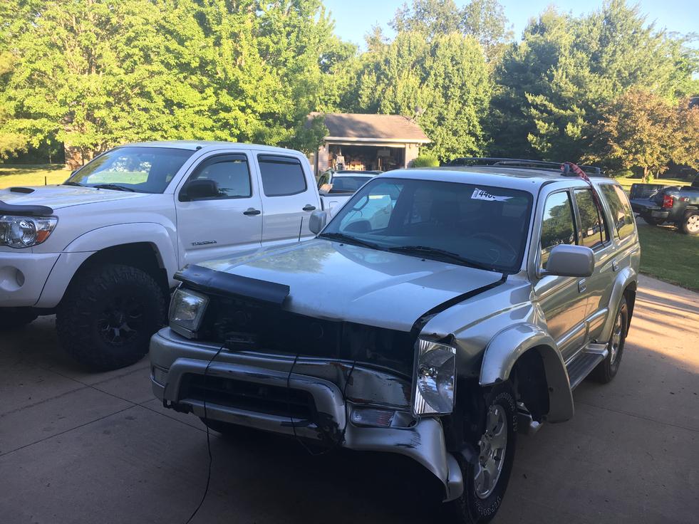

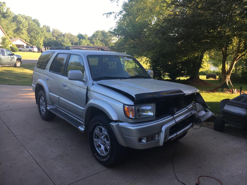

Airbags didn't deploy
jhinderliter
99 limited , My son has a 3 inch scar on his forehead from the sun visor now..
Anybody with similar experiences?

He was running interstate speeds on I 70 and lost control one some ice, he spun around once while on the breaks, That truck hit a concrete barricade at a little under 40 MPH ish..

I have been in multiple accidents with airbag deployment and without a doubt a properly functioning airbag should have deployed in this type of frontal collision.
To everyone saying Airbags can injure you, although I am sure some people have been injured by airbags, it is not commonplace and airbags prevent exponentially more injury than they cause. In this type of frontal impact where the structure of the vehicle is buckled at the A pillars, airbags should have deployed (even old ones).

Alright so I do have a lot of experience, spent over 30 years in the auto body industry, 14 as a shop owner. I doubt very much that truck was anywhere near 40 mph when it hit the divider. Not a heavy hit in airbag terms, and not a heavy hit in body shop terms. Still a lot of damage, and a bummer about your boy's scar, but airbags will kick your ass. All about the rate of deceleration, and if he was spinning he may not have decelerated much at all. I saw hundreds of cars damaged worse than this not deploy airbags, and I've seen parking lot damage that deployed the bags. Be happy that it wasn't an altogether uglier situation. Hope he buys another 3rd gen, I would.

Upon what conditions do airbags "monitor" to deploy themselves? Very fast deacceleration? I'd imagine it has to be something a sensor can push out; and how much the front hood is bent is not one of them.
No need to get all angry at us for giving our opinions. If you wanted only people who had the exact same experience you would never get any answers because the number of people who have had the same exact collision situation happen are slim.
As others have said there is no way he hit a wall at 40 mph. Maybe he clipped it at 40 mph and kept moving, but he didn't run into a wall at 40mph. The truck would be in much worse shape. The damage isn't THAT bad. He should be happy the only damage he has is that one thing. Chances are it'll heal up and be much less noticeable than it is now.
read somewhere that it's 35 mph frontal collision for the 1996-2002 4Runner
Airbag sensors monitor acceleration, specifically negative acceleration. You can't say a 35 mph collision would set off the airbags. it all depends on what you hit. If you hit a wall at 35 mph dead on it's totally different than if you hit a car already rolling at 10 mph. With the wall you will slow down much faster since your vehicle is the only thing absorbing the impact than you will if you hit a car that is already rolling and can be pushed forward by you hitting it.
