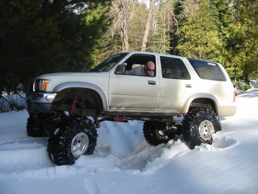

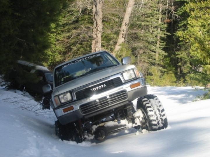

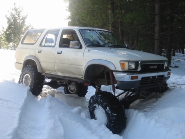

This is true on a road of some sort, but what a lot of people call "snow wheeling" refers to bashing through snow that is deep enough that you're not going to touch the ground surface unless this is your rig
