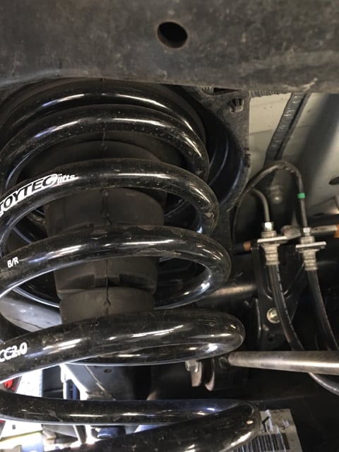

I am thinking of installing an Airlift 1000 kit for towing and when loaded up for camping and I have a few questions.

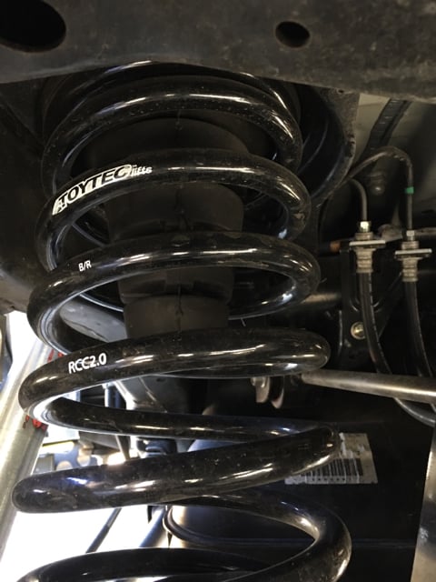

My 2015 Trail has bump stops inside the spring that I believe just act as secondary's to the outer bump stops. They are one piece with the rubber top to the spring and I'm guessing I can just cut off the piece that comes down so the bags can go in right? I attached a pic to support my crappy written description.

There is a picture in the instructions of where to cut the bumpstop in the above picture. As far as I could tell, in no way do , or did, the airbag affect articulation in anyway.

I just installed AirLift 1000 last week on my 2015 Trail. I cut 1st 3 rings off of jounce bumper. With suspension suspended ( watch tension on brake line ) I used a hacksaw blade to cut it off.Rolled up the bags and inserted with the springs still on the truck. Hose side of bag on bottom. Airlift doesn't have a kit on their website listed for a 13-16 4runner. But I used the part# 60809 that Antman had used on his and it worked fine.The instructions say to cut 1st 4 rings off of jounce bumper but those are for 10-12 model years. Jounce bumpers are designed different on the 13-16 model years.

Thank you guys for the replies. Looks like I'm gonna go for it, I just need to crawl under there and double check my measurements for the springs. My truck is lifted so I'm going to order bag based off measurements instead of a kit.

I have these installed for towing and they work wonderfully. Since you've already lifted yours, you can just order the regular part number for the 4R and just not cut the bump stop as far and you'll be fine. I didn't replace the bump stop when I lifted mine and reinstalled the AirLift, I noticed that it still allows for a touch more compression than if I had ordered new bump stops but it still tows nicely. I keep 5-10PSI in mine, able to measure it via a bike pump without issue, it's also how i air them up, only takes maybe 5-10 pumps to get them to 25psi. Definitely the best mod I've done and one of the first I plan to do on my next truck.
