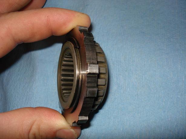

I recently picked up a pair of Aisin Locking hubs. One was pretty dirty, it had a brownish grease like it was submerged in water. The other was pretty clean. I'm in the process of rebuilding them. I've only been able to disassemble the dials, at the moment. Before I tackle the hub gear, I noticed the dirty one spins pretty easily, while the cleaner one is a little harder to turn, but does turn.
My question is how free should the hub gear turn? I'm assuming this is the part that will connect to the Axle and the rest of the hub will be turning around it while it's in the FREE position.
Attached is gear I'm describing. (It's from the IH8MUD.COM Forum)

I just cleaned and installed a set I got on EBAY and they were semi crapped up.
Take the snap ring off and clean both parts. The inside of that gear has a bronze insert that has holes in it to hold lube. There is probably some dried up smutz (Technical term) that is keeping it from moving smoothly.
You'll want to get that out of there so that you can properly grease them.
Snap ring pliers are your friend here.
