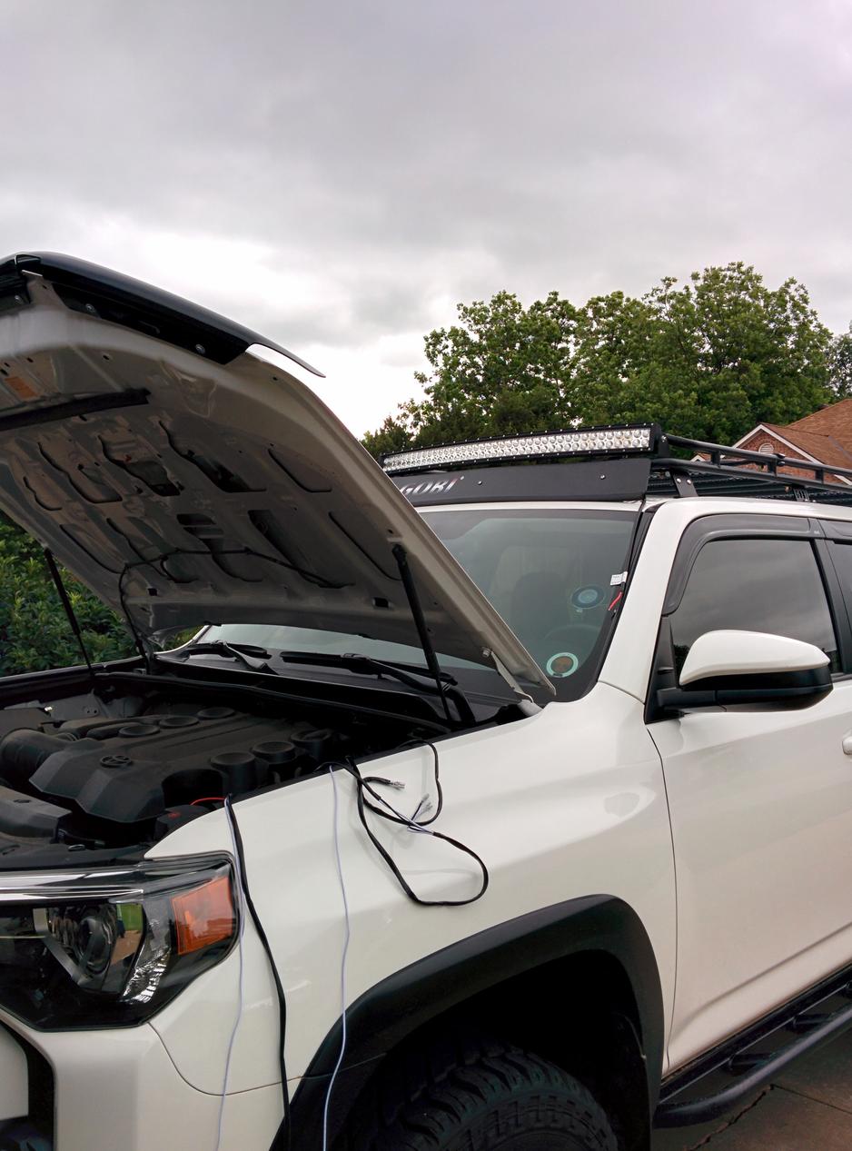

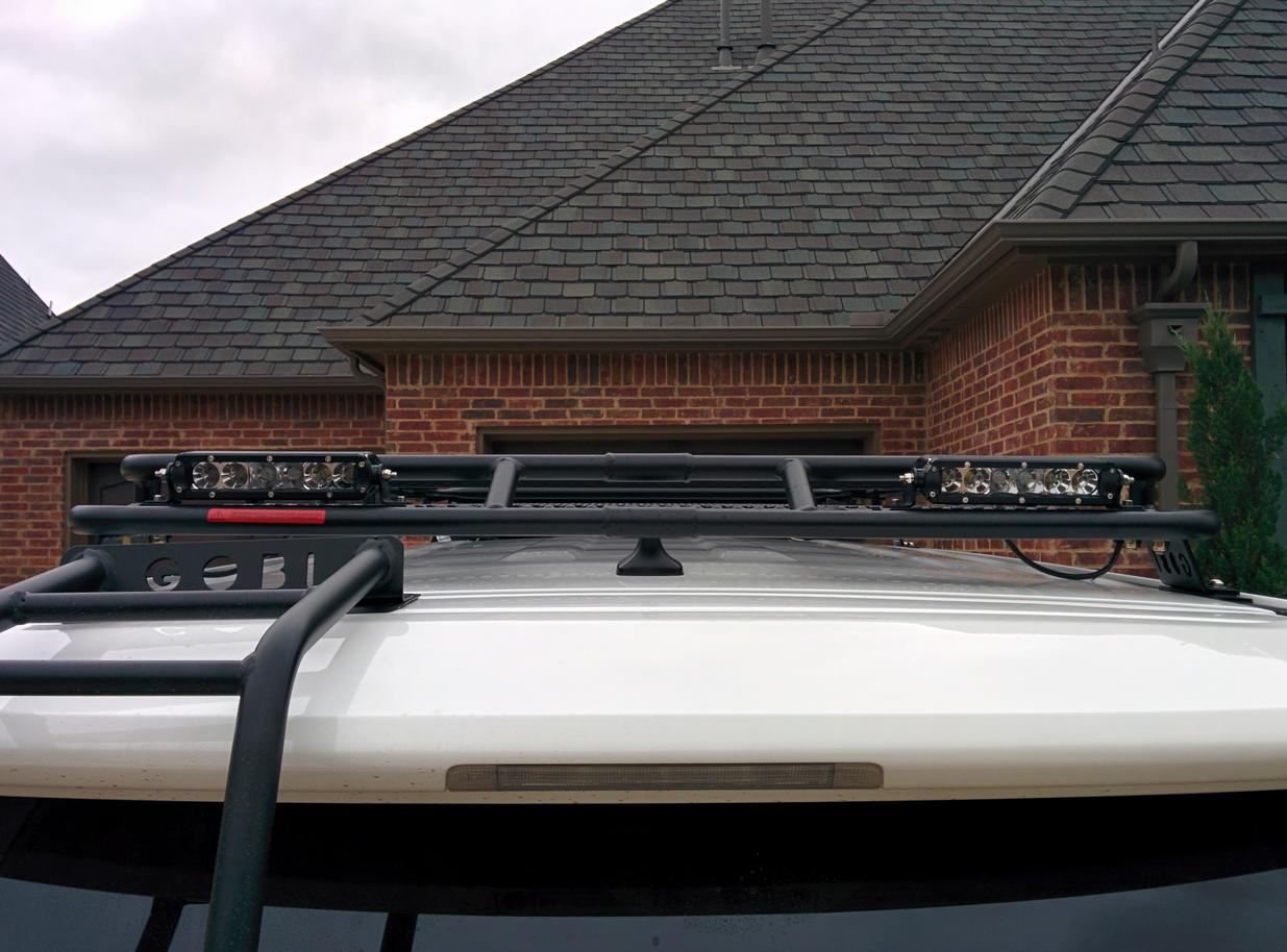

Got the lights in today and mounted up. Still have to finish the wiring and adjust them. The GOBI bracket is somewhat finicky and doesn't quite hold the curved bar how I'd like it. May have to change that up.
Turning them on in daylight they seem pretty damn bright. Will get a real test in when the sun goes now.

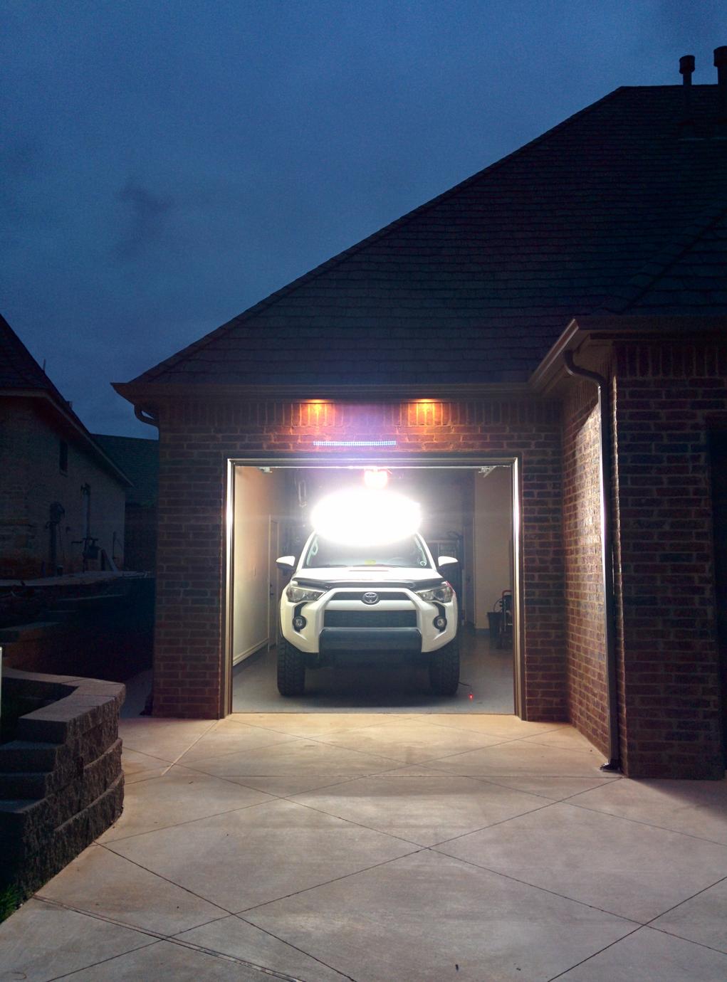

Not bad for $199. Bright as hell IMO and more than exceeds my expectations. Easily lights up objects a few hundred yards away. uploadfromtaptalk1432226528975.jpg
I got the Desert Rat curved lightbar mounted yesterday, and experienced the same thing I'm guessing you did. The brackets are very specifically meant for a straight bar, so if you leave them as-is then the bolts will have the torque side-loaded at an angle going into the curved bar. We ended up cutting the vertical piece that holds the bar to separate it from the horizontal part that mounts to the rack (and the fairing, which was issue with just trying to rotate that piece more) and welding in a different piece to allow us to turn the mount to align with the curve of the bar...royal pain...
I got the Desert Rate curved lightbar mounted yesterday, and experienced the same thing I'm guessing you did. The brackets are very specifically meant for a straight bar, so if you leave them as-is then the bolts will have the torque side-loaded at an angle going into the curved bar. We ended up cutting the vertical piece that holds the bar to separate it from the horizontal part that mounts to the rack (and the fairing, which was issue with just trying to rotate that piece more) and welding in a different piece to allow us to turn the mount to align with the curve of the bar...royal pain...
Yep, that's the exact problem I am having. The curvature of the bar is keeping me from being able to angle it down past horizontal. I don't have those fab skills, or a welder, so I'll have to figure something out. Someone in the Group Buy thread mentioned he changed the carriage bolts out and was able to spread the brackets out a little wider. I may give that a try next.

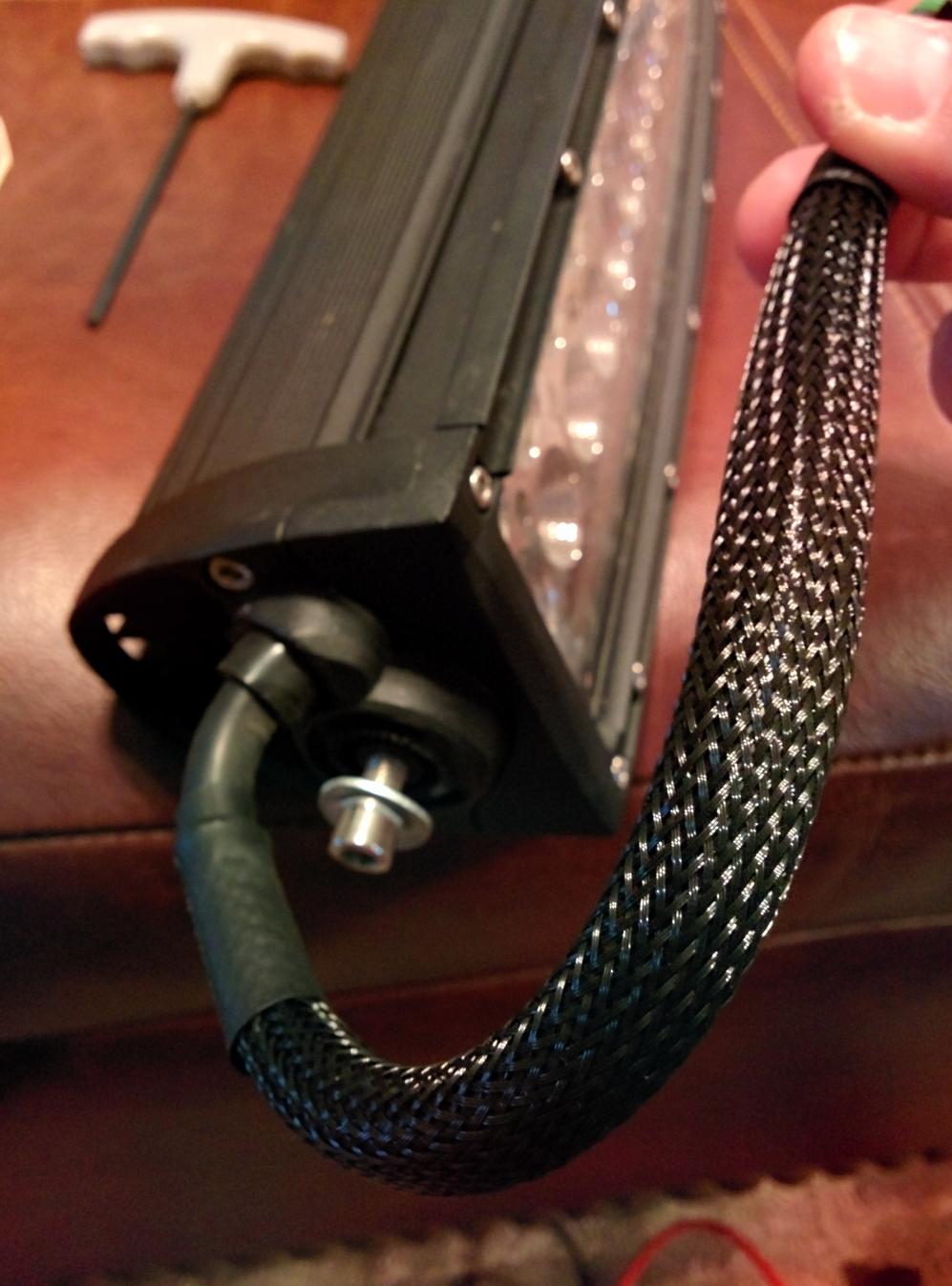

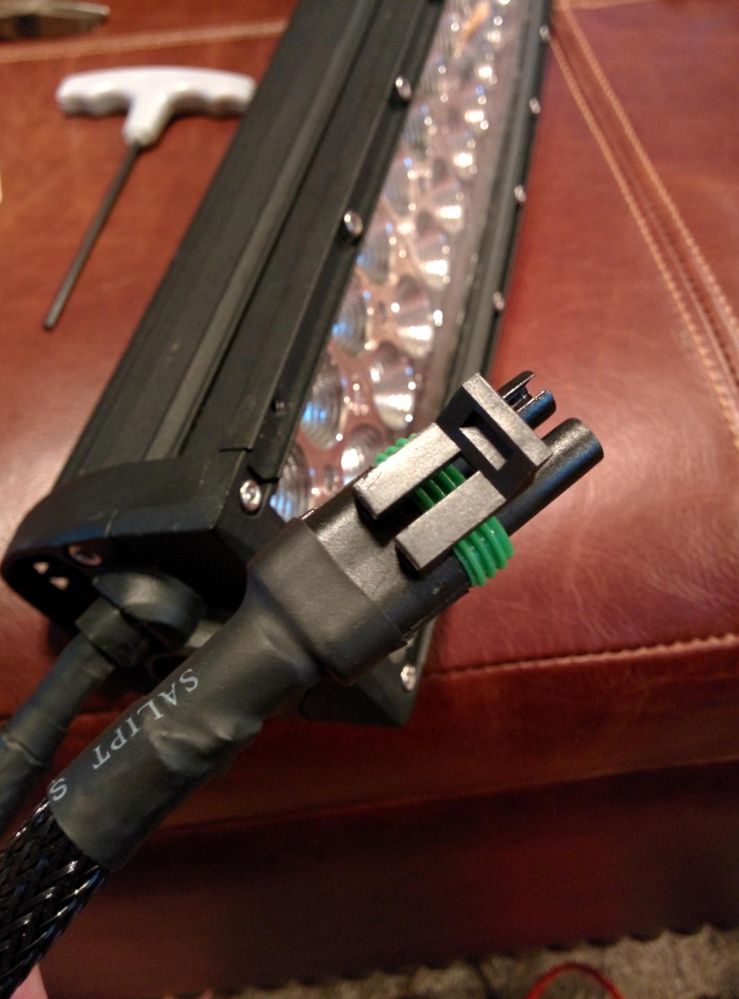

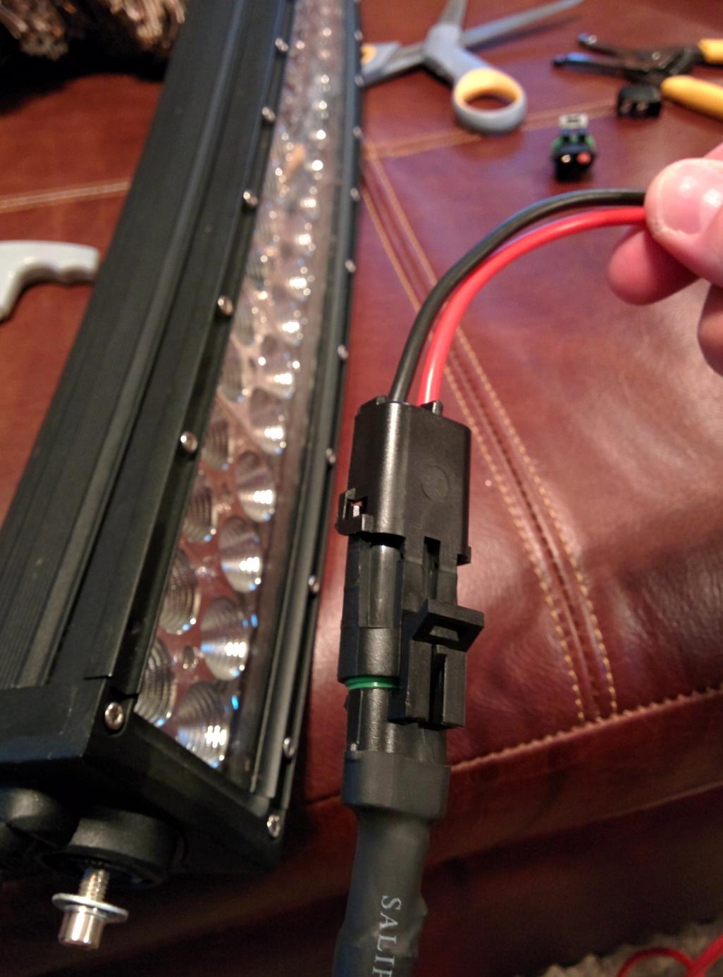

Received some techflex cable sleeving and waterproof connectors in today. Got started with the bar and new harness. Bussman fuse/relay block will be here Saturday.

Wiring Complete!
Finally finished up the wiring for the LED lights this evening. Ripped out all the old Chinese wiring and replaced it with proper gauge running back to the custom Cooper Bussmann fuse box. Ran 12AWG wire up the driver side to the 40" LED bar and connected using waterproof connectors. Now the wires and connector only get slightly warm to the touch after being on for 5+ minutes.
For the rears, I extended the driver side wiring in the GOBI and fished it over to the passenger side. I then combined the 2 18AWG wires for driver and passenger side rear lights and used waterproof connectors to connect to 12AWG leading down the passenger side to the engine bay. Also covered everything between the windshield and rack with techflex sleeving.
Was pricey and time consuming, but well worth the comfort knowing I can run everything and not worry about starting a fire :flame:
