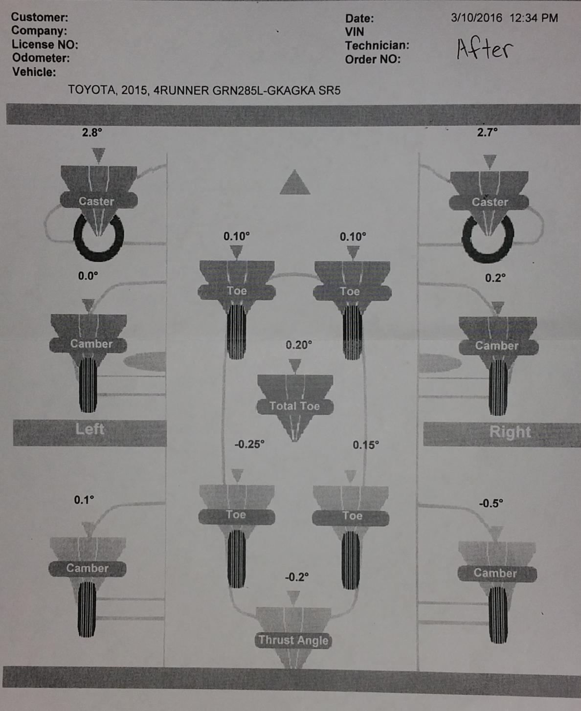

Small update now that I have the TC cam gussets installed. Got them installed yesterday and picked it up late after I got off work. On the drive home I was annoyed to find that it still pulls to the right slightly. I know we have pretty sloped roads here in AZ but when the slope is to the left the truck drives straight rather than take off left. As you can see in the opening post, the previous alignment shop had created a decent cross caster to get it to drive straight. Obviously the new shop just matched up all the adjustments left and right and pushed it out the door.
Anyone have any other ideas what could be causing this?

I'm also having issues with alignment after Bilstein 6112/5160 install, the fronts are on the 4th clip from the bottom, rears have 2" springs no spacers. I couldn't get caster in spec.
After few months and several alignments I gave up and just installed Camburg UCAs based on what I read on this forum. Well I was expecting significant improvement and I can't help but feel that I wasted a lot of money. Alignment shop took 2 hours and couldn't get caster to go more than 2.8. For the experts out there can someone help me how to get more caster the steps fro proper adjustment, should all bolts be loosen at the same time or one by one? which one to adjust first caster or camber rear or front bolt of the LCA? I know some of you will say take it to another shop but I'm running out of options here.
One thing I learned from the several alignments done so far, if there is a 0.5 deg difference in caster (give or take) between the right and left wheels the vehicles drives better or smother, if both are the same she feels jumpy or jittery

The camburg UCAs should help quite a bit. They don't offer the most in terms of caster gains, but they do improve it and are durable and well made.
The adjustment process is outlined in the repair manual. It includes a chart, but it is difficult to explain.
You basically want the wheels as far forward as possible. Rear cam is typically set to push the rear portion of the LCA outboard as far as possible. Front is set to pull it inboard but you can only go so far and maintain near 0 camber.
