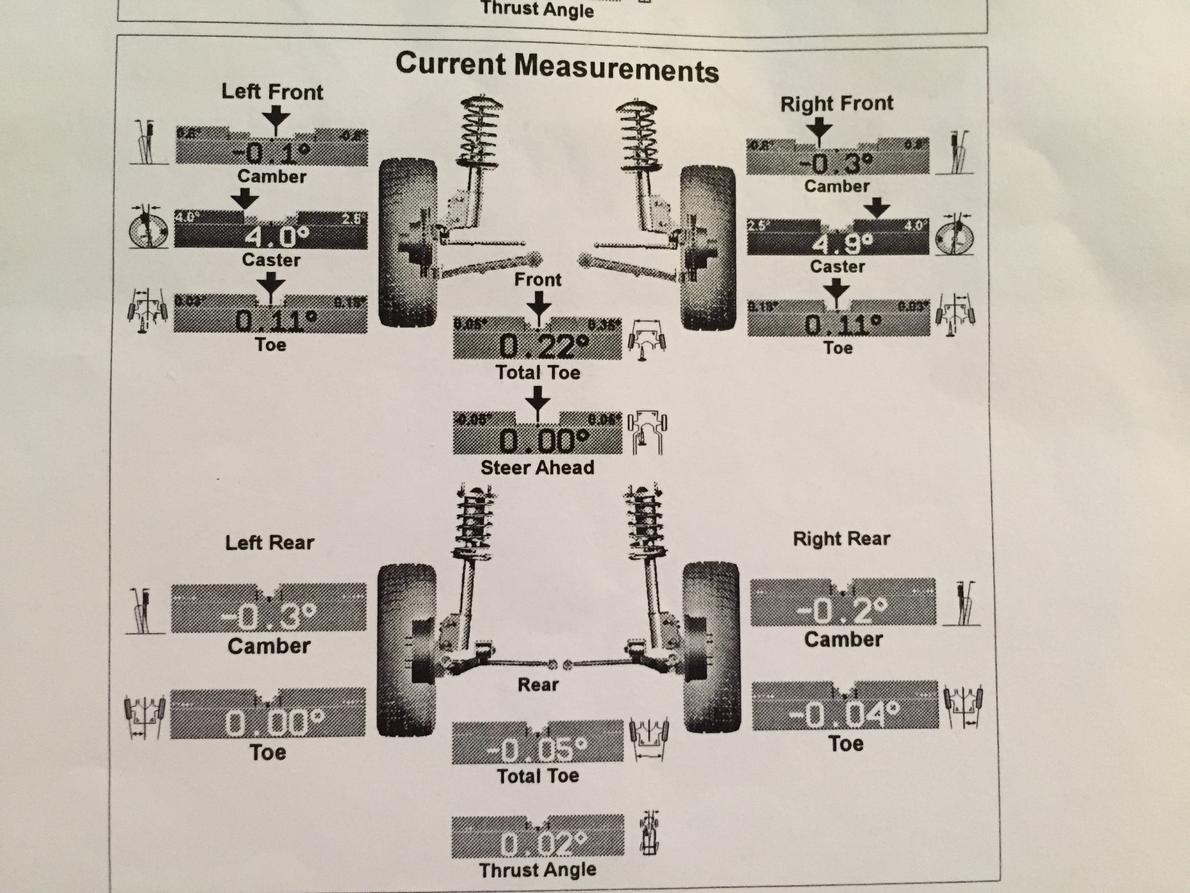

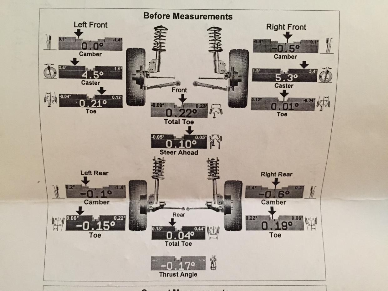

For the specs below. First set is from my first trip to the new shop. I then drove it ~1k easy miles and took it back cause it was still pulling right. Odd thing is the "before" alignment from the second trip shows some changes over the previous settings, namely in the toe setting. Last set is my current settings. It does track straighter but it still pulls right, and I can't help thinking having the caster set so differently isn't right. Lastly, their opinion is they can next adjust driver-side camber to be more positive, but they're afraid of having the truck start to pull left too much. Also, I installed a new track bar between alignments as well to re-center the rear axle, which also happened to pull the rear out of alignment (go figure).
My thoughts are that I'd like to try having caster relatively even, both around 5-degrees, and see what adjusting the camber up on the driver side will do (basically how they set it up originally but increase the difference). Thoughts are much appreciated.
In Order: First trip alignment specs. Drove ~1k easy miles, took it back

Unfortunately, on some vehicles you do have to create a huge caster split to make them drive straight. Although, usually you don't see too much of this on Toyotas. If the numbers are true, I'd increase the camber on both sides to about -.15° on the right and about 0° on the left but keep the caster right where you have it. To me, -.5° is a little too negative,. If it still pulls, I would increase the caster split until it no longer pulled. As a last resort, I would even adjust the tire air pressure, maybe something like 32 on the front left and 38 on the passenger front.

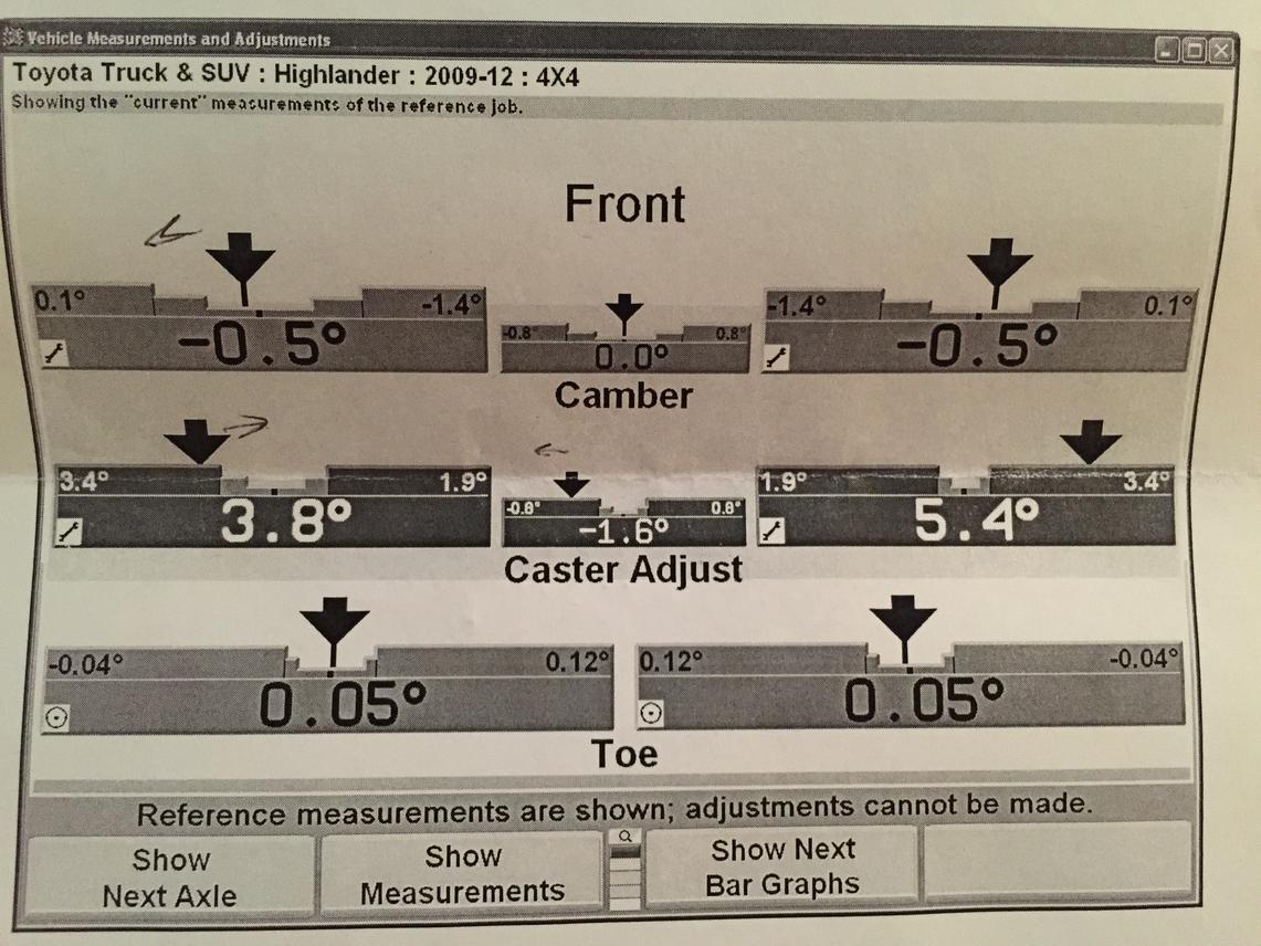

I also noticed the shop had Highlander specs pulled up instead of 4runner specs.

Problem is the measurements aren't symmetrical.
Have the shop get the caster on both sides exactly the same. Many times the vehicle will pull to the side with the most positive caster.
Additionally, have them take some toe out. +.11 on both sides can make the vehicle susceptible to tracking with the road imperfections etc.
Try to have the shop adjust caster +4.0 to +4.5 on BOTH sides
Camber at 0.0 to +.2 on both sides
Toe adjust +.03 on both sides
Getting a super precise toe measurement is going to take a bit of time but it can be done.
Adjust. Jounce suspension. Adjust. Jounce. etc.
A competent tech can make it happen.

This is what my feelings where. I think I'd like to have it set perfect on side-to-side and go from there. As far as I know it hasn't been perfectly even since I installed the suspension cause I always noted a righthand pull. Everything I've read indicates vehicles pull to the side with the least positive caster so your comment's a new one on me, but either way I feel it's not right considering it wasn't necessary before. I think the next step is to have it setup as you describe, if anything to establish a baseline.

Looking closer at your specs, what gets me about it is the rear settings--before and after. On T4R and 99.99% of all (unless you have rear steering) solid rear axle vehicles, adjustments aren't possible. Their toe numbers are all over the map. Granted, the rear measurements fluctuate a bit as you adjust the front, but not like what they have going on.
Makes me suspect about the calibration of the machine...more likely is the guy using it. Especially with having the "Highlander" listed in the header on the paper. That's lack of attention to detail. If he can't get the vehicle right he might be a tech thats only competent enough to put air in bicycle tires.
As Maverick stated, go to a recommended shop and have them get the numbers balanced and the T4R will drive straight.
