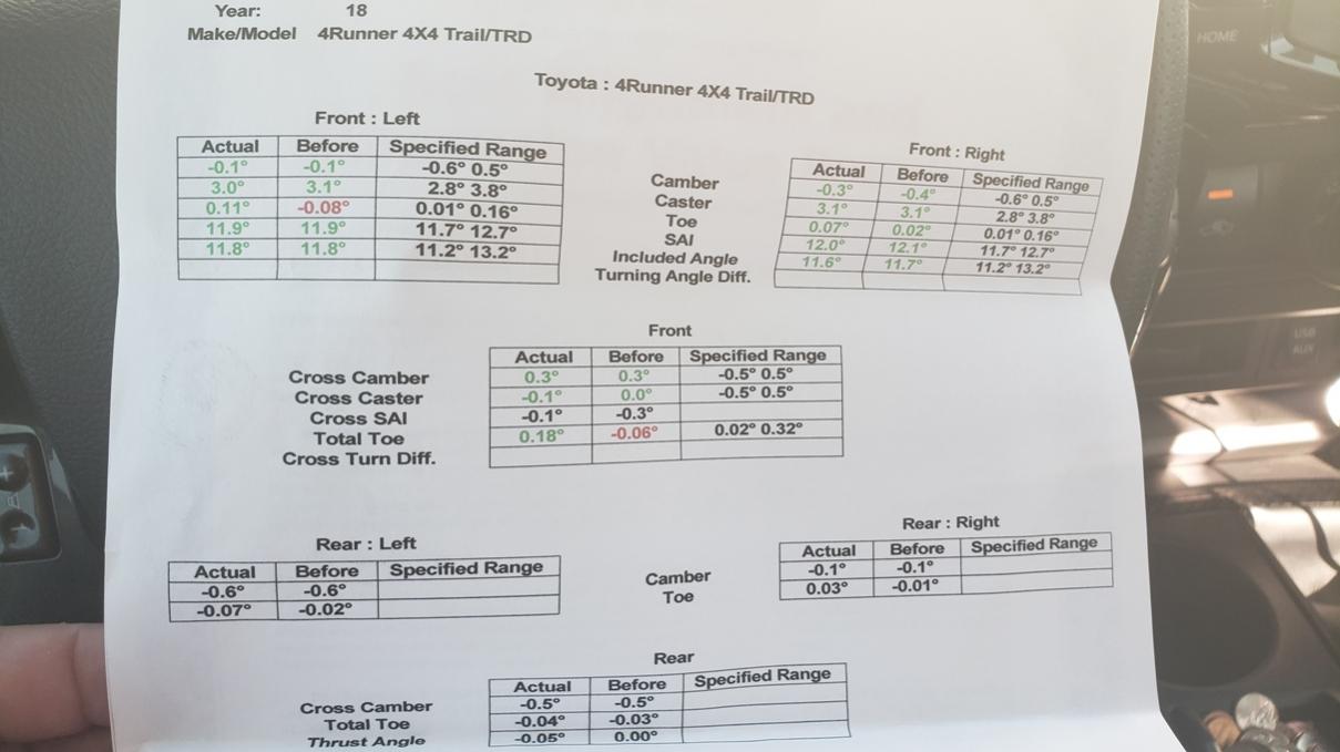

2018 Bone Stock TRD Off Road. Long story short, I went to Les Schwab for an alignment as I just had some Grabber ATX's installed and it hasn't had one since leaving the lot (20K miles).

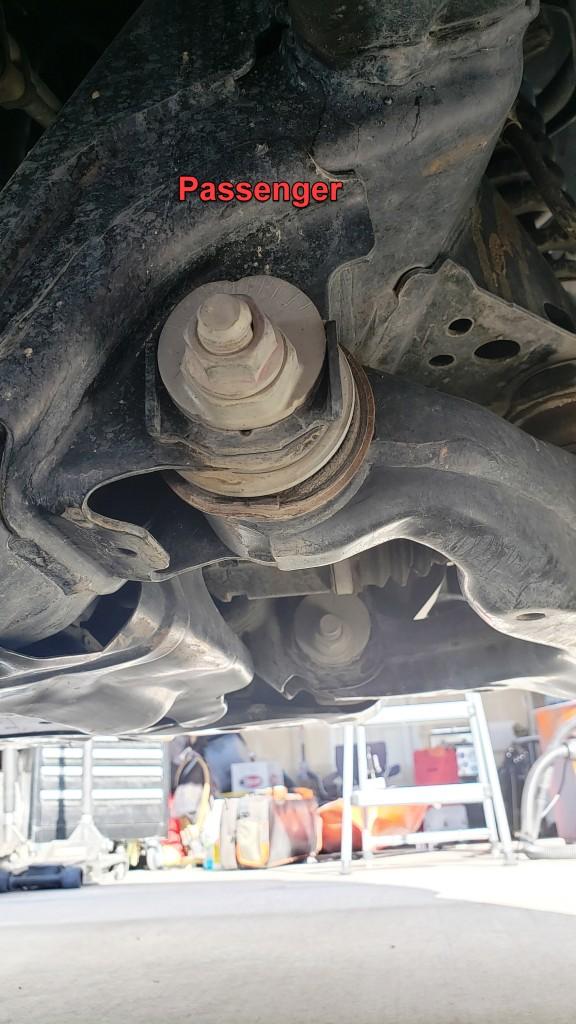

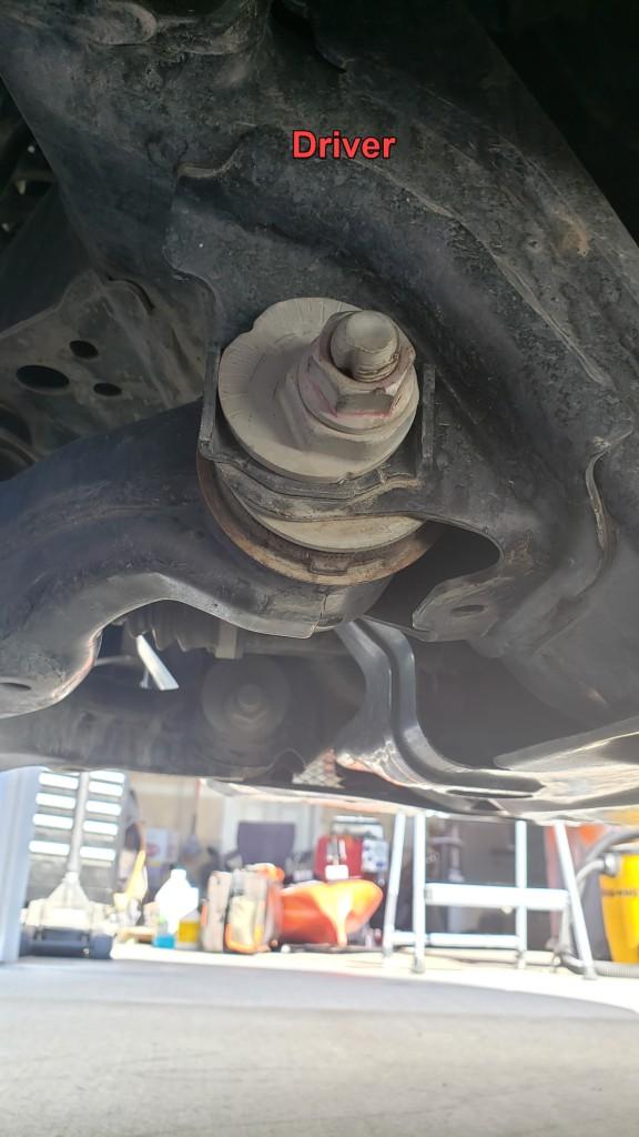

I got under the rig to wipe off some excess grease that was on the cat from greasing the front drive shaft and noticed that the drivers side LCA adjustment cams were clocked quit a bit more than the passenger side. Is this normal? Or am I being too OCD? lol
It's a mall crawler, so I cannot recall hitting serious potholes or anything like that.
Any help would be appreciated!

I'm not an alignment guru, but I would think that every combination of tire, wheel, suspension component, etc sets up slightly differently on all four corners. That's why they build so much adjustability in. As long as you're happy with the ride and tracking, I wouldn't be concerned.
No frame is perfectly square, so there are adjustments to align to spec........and they used them. The numbers are what matters, not the position of the parts.
