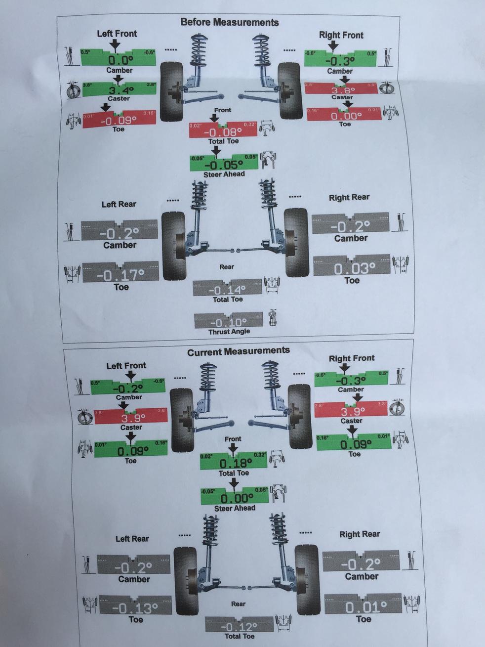

Hey guys, I finally lifted my 4Runner yesterday. Toytec Boss with LR UCA. So i went and got an alignment today. Long story short, It was a nightmare... Essentially Im wondering if any of the alignment guys out there can tell me if my numbers are ok? The alignment specialist said he couldn't get 4 degrees caster. I know he didn't touch the control arms. I gave him the instruction sheet and he didn't even look at it. I preset the UCAS in the D position at 2 Degrees caster. I plan to go a little higher on the coilovers in a couple months so i figured I would get another alignment then, will I be good?
Caster 3.8
Camber -0.1
Toe 0
Thanks in advance!

I'm not sure how it was a "nightmare" but the numbers in the sheet you posted look about perfect.

Generally, you'll never get a pull unless the difference (Cross-camber and cross-caster) from one side to the other is greater than .5 degrees. He may be talking about road crown compensation in which you make the drivers side less positive or the passenger side more positive (caster pulls to the less positive side) You do this with caster because it is the least likely angle to cause tire wear. As an example he could have set your drivers side caster to say 3.5* and the passenger side to 3.8 or so. You wouldn't want to go to .5* because then you might pulls to the left on flat surfaces.

WITH THE TOE @ZERO YOU WILL HAVE DIFFICULTY keeping the vehicle straight on a bad road. zero is min spec max spec is .35 total toe . you need some toe positive . like .1/.15 deg..

looks like your corrected total toe is .19 which is in the middle of the toyota spec...
his being zero is not proper ..

How does this look to you guys?

Here's what's missing from the conversation:
IT DOES NOT MATTER WHAT YOUR FINAL NUMBER IS! What matters is two things:
1. Is it within spec and
2. How does it drive?
You can have a caster of 2.8, and, if it drives good then it's fine. Driving does not get "gooder" lol.
Caster it seems, needs to be towards the higher end of the spec range to be "good," which means it does not feel skittish on the road. The value of "4" is not a magic number. It seems too many people think they must attain that number. In reality "3" or "2.5" might be just fine, depending on the other alignment settings. People who are trying to stuff big tires under there increase caster to give the tires a bit more room as a main reason even though it drives fine at the current spec. So "4" is nice but then again, "3" could be just fine.

Well like I mentioned before this alignment I was having to correct the steering constantly meaning no it wasn't driving good. After the alignment it seems to drive a bit better as far as not being turned in one direction or another from the slightest wind, dip, off camber etc.
However the caster numbers are out of spec by .1
I guess my question is being out of spec on caster by .1 going to do unnecessary wear to other suspension parts when the suspension cycles up and down?

0.1 shouldn't impact anything
at a certain point you get into dynamic problems because of the trail amount, but you shouldn't be anywhere near that point

That caster is perfectly fine!
However you want a "toe in" to keep the 4R tracking straight. Not a lot, just a tad, otherwise you'll have aggressive tire wear and Lord knows we don't need that haha
