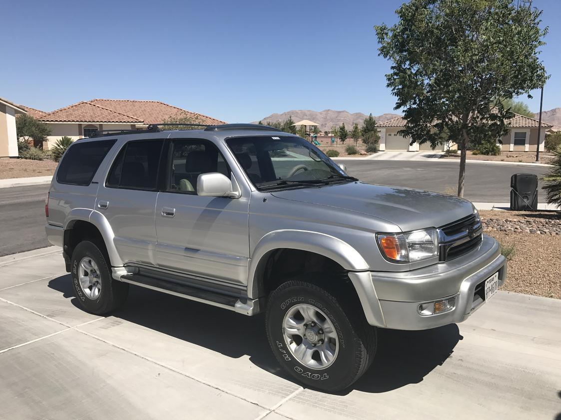

I just recently (yesterday) put a Toytech Boss 3" lift on the 4Runner. I took it into firestone to get an alignment today. They wrote that the camber/caster are maxed out. The steering wheel also has to be turned a bit to the right now for the vehicle to go straight. I'm not knowledgeable about alignment and steering so I have some questions.
Should the camber and caster be maxed out with an ~3" lift or did they just do a bad job? Is the steering wheel off center because of something they did during the adjustment. Do I need to replace any stock parts because of the lift?
Here she is with the lift:

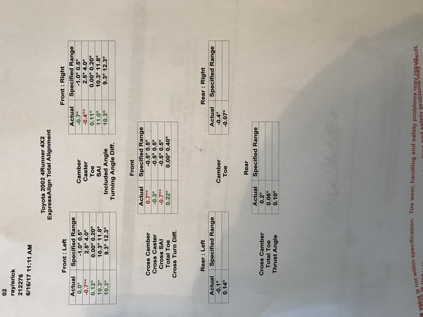

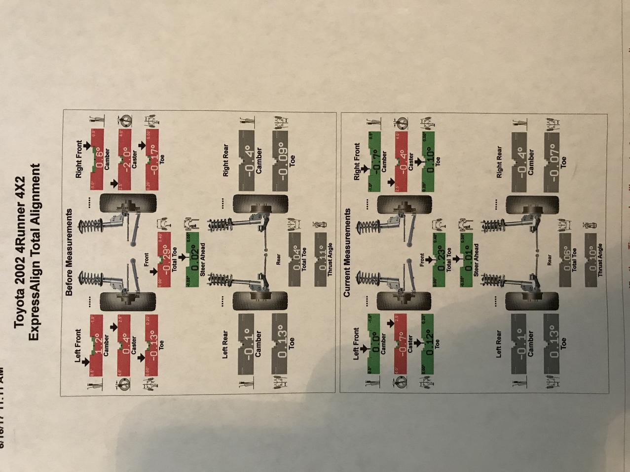

I brought it into Southern Tire Mart, and they basically said that Firestone screwed up bad. They got it all squared away. They said it has a little radial pull that only new tires will fix. I was thinking of getting Toyo R/Ts.

Cross camber is out of spec. It seems that 0.7 degrees would give you a little too much pull to the left on most roads, especially if you drive in the left lane a lot.
Next time when you get aligned with the new tires ask them to max the caster. You are in the negative and even with a 3" lift they can get you within spec. Usually around 1.2-1.5*.

Yeah I'm not digging the whole negative caster readings. I know you may not get up to 3.0 positive, but negative? No thanks.
