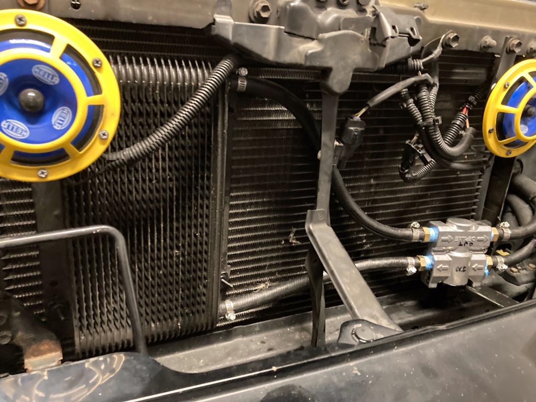

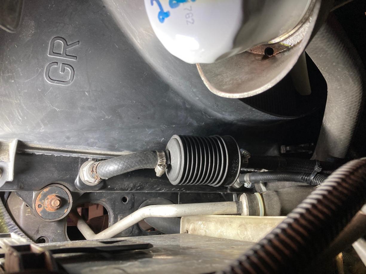

The cooler I prefer is the B&M 70264 with 3/8” ports mounted on the AC condenser. This allows the fan to draw air across it and alway provide airflow even when standing in rrush hour traffic in the summer. Its the most efficient setup. I also added a derale bypass so it does not overcool the ATF in cold winters.
Magnefine Inline Transmission Power Steering Filters
thanks for the detailed info and pics. The V8 has a trans cooler. The Magnefine filter may be a good idea if i decide to do a DIY full fluid change. I hesitate to throw a different ATF in there, esp if i'm not experiencing any issues. I do have an OBD scanner that shows operating temp for the trans are in the 170s. What i may do is drain out the pain, refill with WS and send some off to Blackstone for an analysis.
