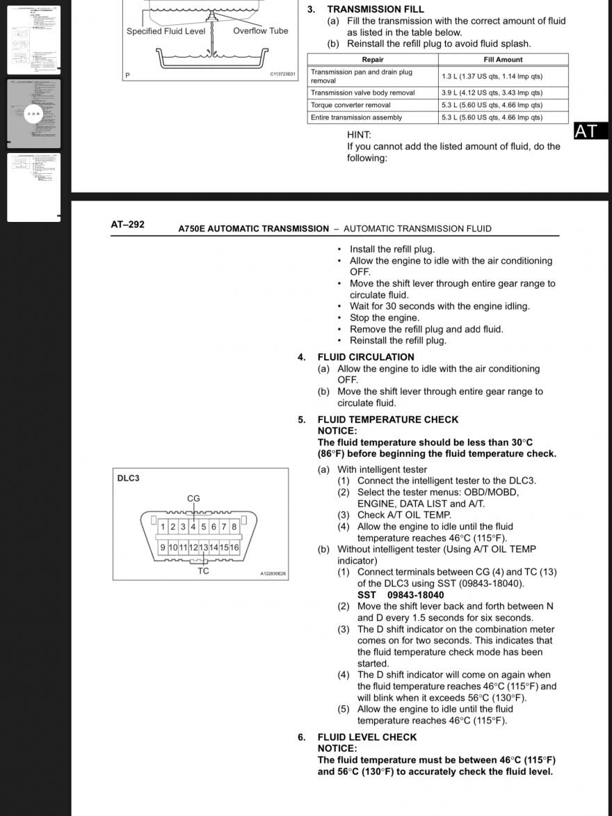

This is from the FSM. First note that the temp range is 115 to 130F (though I've seen disagreement here and there). If the fluid is at the correct temperature, the design of the overflow system ensures the correct amount of fluid is in there. You either wait until the flow is a trickle and replace the overflow plug or, if nothing comes out, you add fluid until it comes out of the overflow then replace it when the flow is a trickle.

I’ve seen that range before but the FSM says 115F to 130F (see page in my post above). Was there a service bulletin revising the temps, or what’s the source on the 105F to 115F range?
