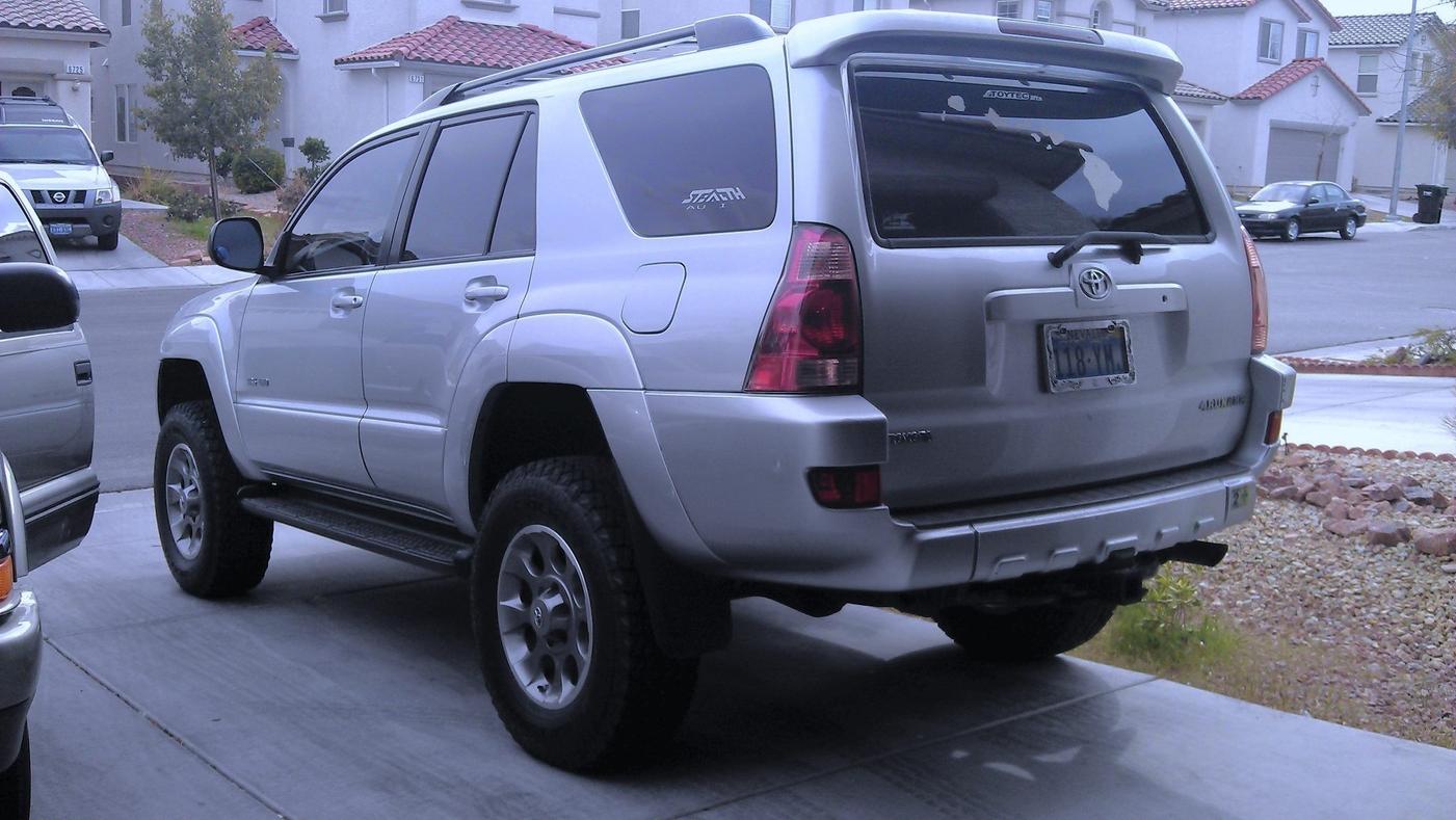

here is a pic of OW 2.5 with AP 3.5" springs...freshly installed.
Too high in the rear without any weight in the rear or cranking up the front. IMO, the spring rate is too light once you get a bumper on too.
