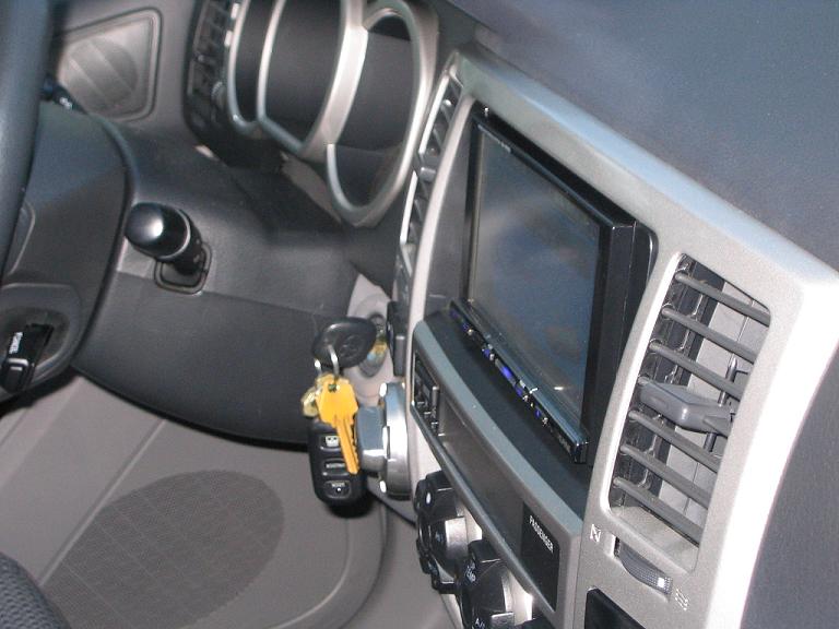

Joe, I'm one of those that did not like the way the Alpine looked in my 4Runner so I sent it back (Crutchfield). Can you detail the mods to your brackets and possibly clik a pic of the finished look? I loved the unit but hated the way it looked in my dash, if yours looks better I may decide to re-buy the same unit. Thanks
The Toyota mounting brackets have little bumps that fit into holes on the HU that register the brackets to the HU. So essentially, the brackets click into position and then you screw in the mounting screws to the threaded holes on the HU. I saw that there were another set of threaded holes on the HU that lined up with the brackets, however, the bumps did not have registration holes to click into. So I sanded down the bumps and mounted the brackets in the forward most set of threaded holes on the Alpine. This allowed the HU to sit back an additional half inch or so. That does not sound like a lot but it made a big difference in the way it looks in the dash.

Joe, your HU looks awsome. I've decided... I'm getting it.
