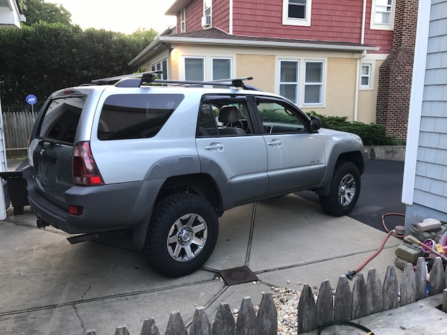

pic
here is how it sits

In all reality you're using a stock spring that's preloaded and I'd imagine that the spring rate isn't that high since it's for a stock v6. I'd look into the 885s on the 0 setting. It's a stiffer spring and with the v8 will probably keep you level with the 1" spacer in the rear. I initially had about a 3" lift on the v6 but after everything settled and I added weight I was probably down around 2-2.5" Not quite sure since I never measured before I put the Icons on.
Wow I overlooked that fact! In retrospect I would have gone straight for the stiffer OME or ICON springs. I wouldn't do just the fronts all 4 springs should be matched.
