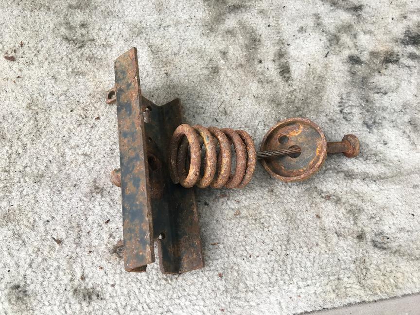

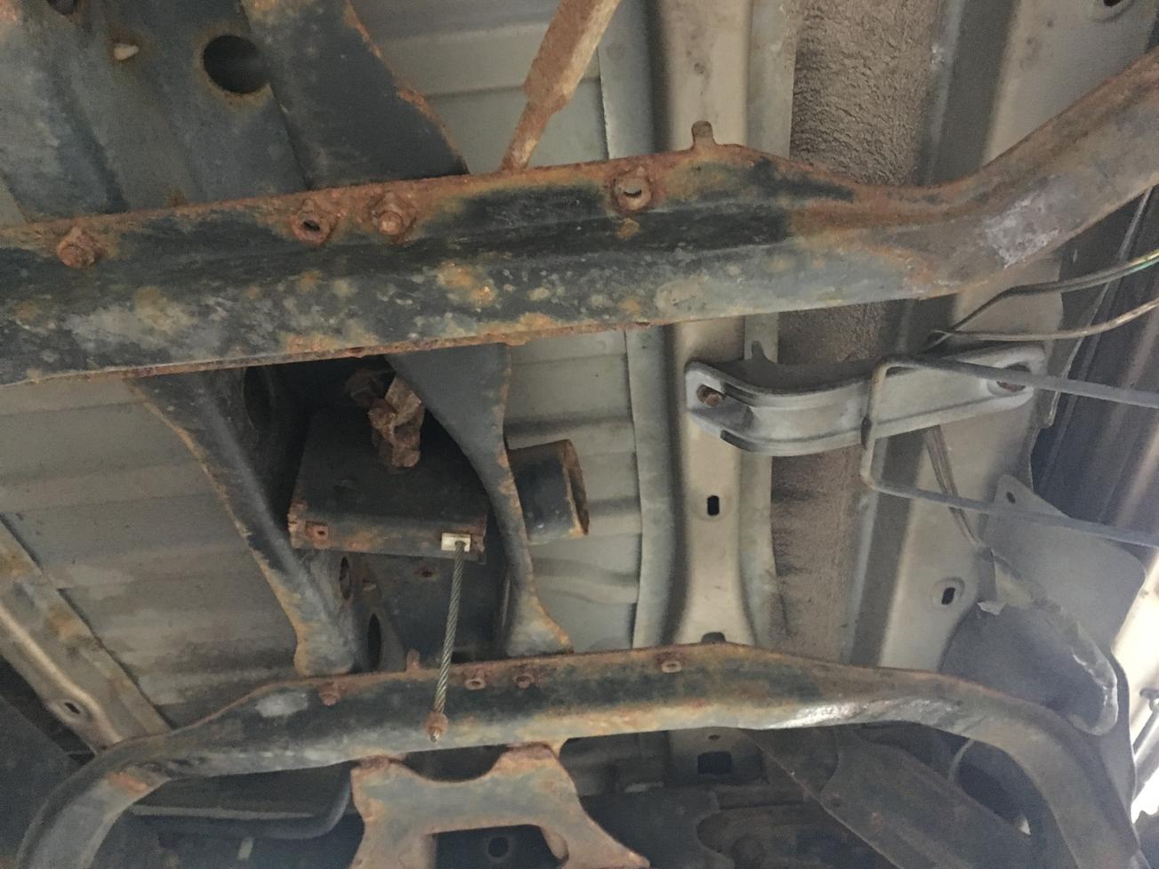

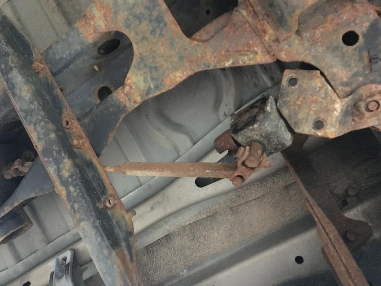

Here is some photos of what I am working with:
the first one is the part that fits underneath the tire
the second and third are the undercarriage showing the many opportunities for threading some chain around parts of the frame..

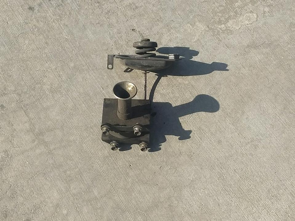

P.S. I have a clean California one I just removed from my 1997. as soon as I get 15 in I can post a picture. lol

I removed the whole setup off of my 97, and I have a setup for a first gen also.
1gens have a chain. my 3rd gen is a cable
I'll take a look and see what I have.

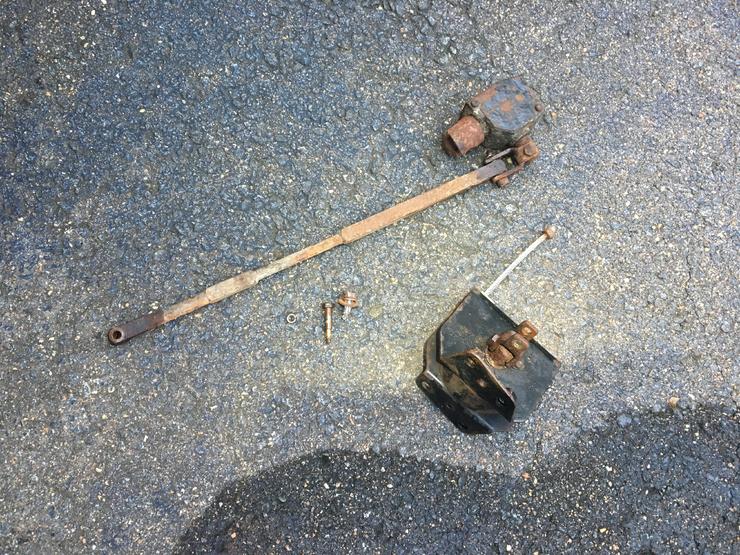

Hi guys, want to close the loop on this (for now!). This is what I removed (after having to drill a rusted bolt out!!)

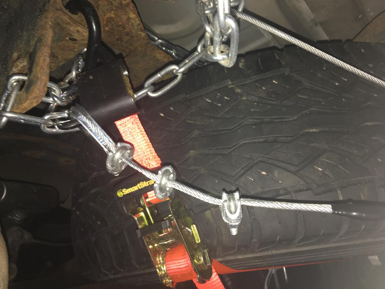

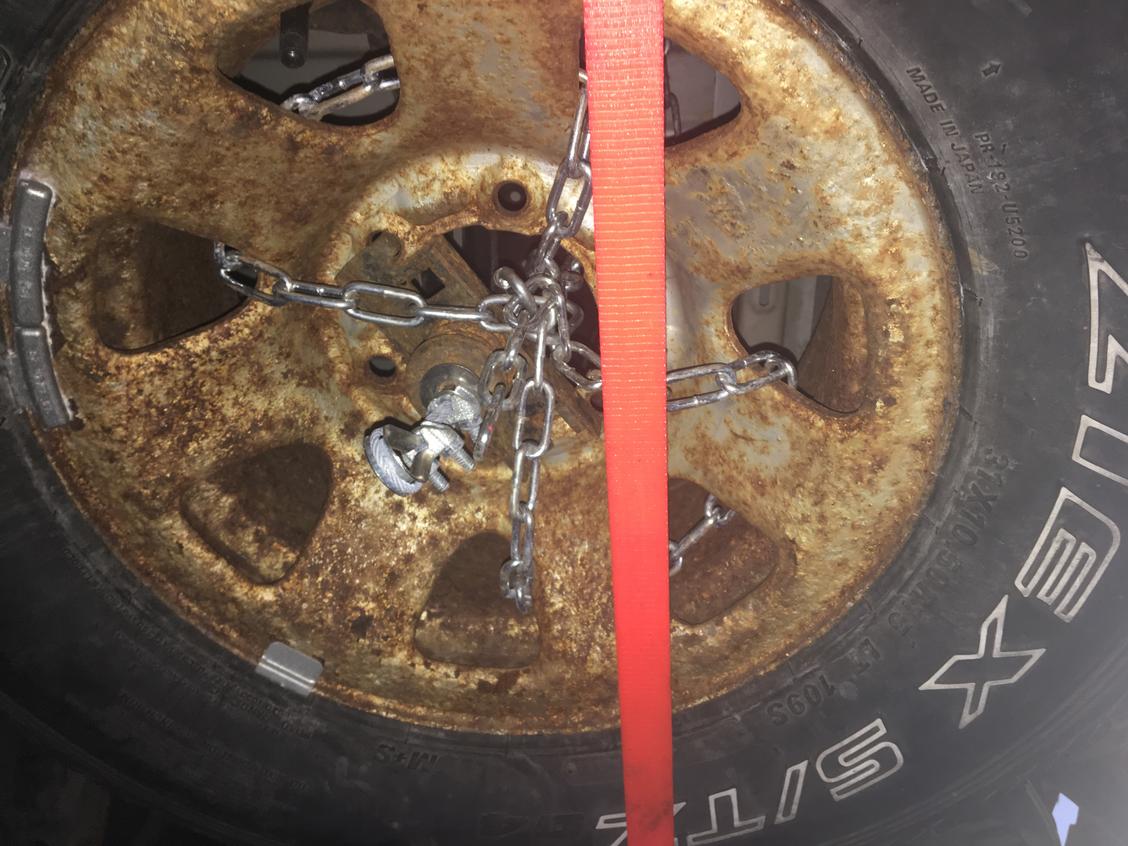

and this was my solution - cost about $25 and maybe 1.5 hrs of time. I didn't really want to trust one solution, so I used a chain, cable, and ratchet strap (the ratchet strap is mostly to make it easier to raise and lower). I'm actually not sure how long the ratchet strap will last being exposed to the elements.. but at least none of these components are susceptible to the issues that plagued the over engineered cable pulley assembly, and way cheaper!
not pictured but needed - a couple of these 1/4" steel quick links to attach the chain to itself, and run the cable through so it isn't rubbing against raw steel frame..

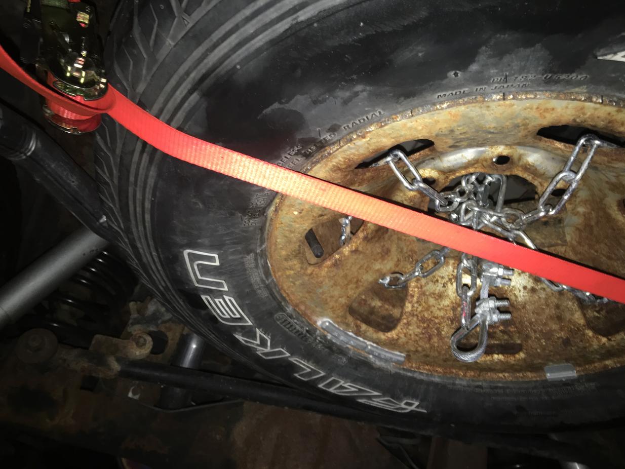

Here is it before I raised it up:

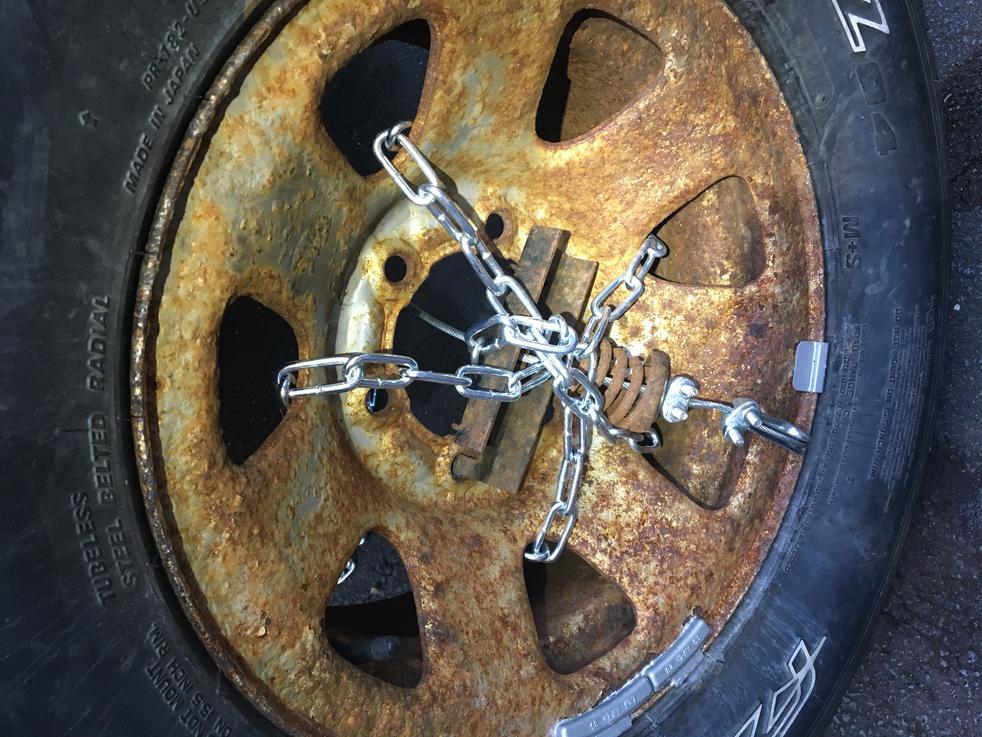

Here is it all tightened up:
The chain and cable are both attached to a padlock attached to the frame.
Hope this helps anyone who may be interested in something like this.
