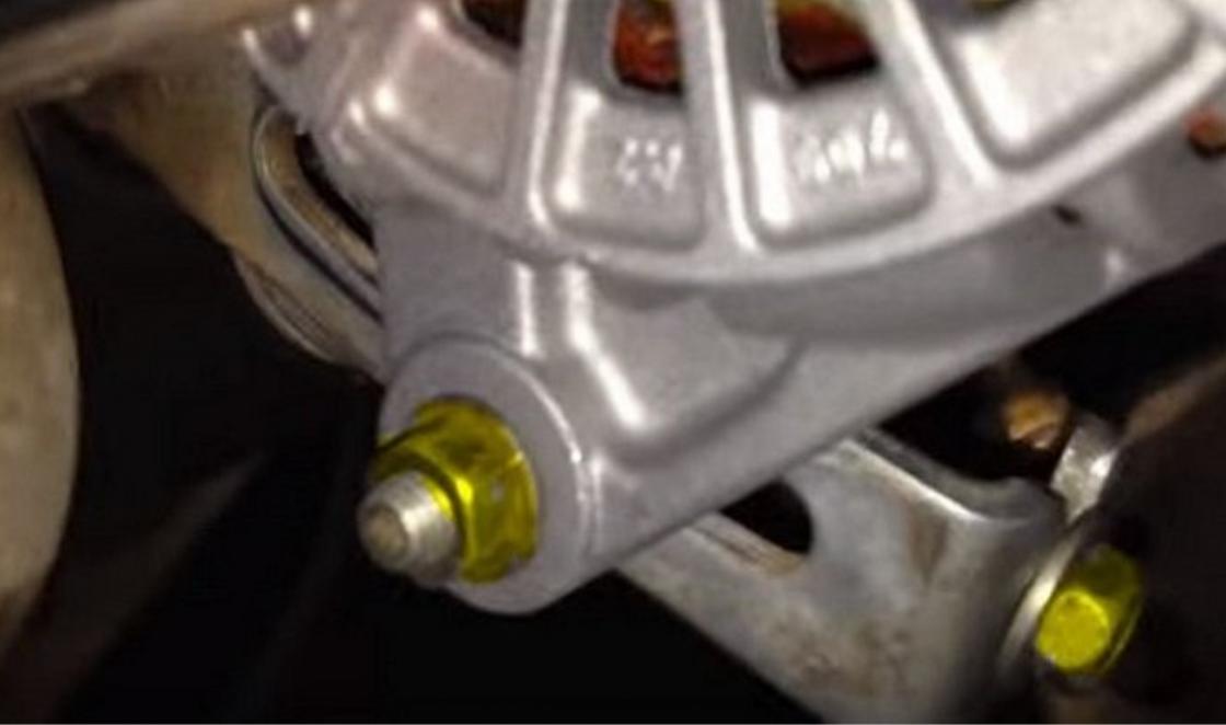

Alternator Bottom Bracket?
Be careful the ft/lb torque spec for that tensioner bolt thing is wrong in the service manual. Take the Nm value and convert it for the correct spec. It strips out super easy.
just wanted to confirm what Repo mentioned above. 18.5nm = 13.6 ft-lbs. The book specifies 25ft-lbs and can confirm, the nut strips if trying to reach that spec (ask me how I know) :pop2:
