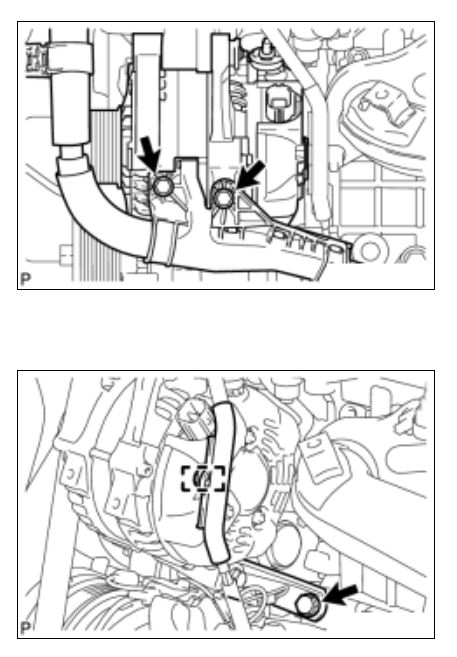

Got the alternator and the infamous rear bracket undone, but can't figure out how to remove the harness and the terminal wire.
Also there is another harness that fastens to a bracket on the back of the alternator. Seems like I'd need to remove it from the bracket.
IIRC, there are 2 10mm bolts between the alternator and wheel well holding on the wire harness, and the harness in the back unclips. Terminal wire - a plastic cover should flip up that covers the stud and nut.
I got it. Bolts holding the harness are easy. The cover over the terminal is not intuitive, nor is the harness plug itself.
New alternator installed. Showing 13.72 volts at idle. All is good, but my large hands are pretty scraped up.
