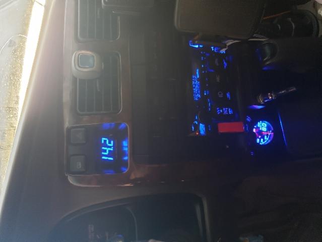

After some unlucky times out on the road in the past, i always keep a multimeter with me as stated above, its a life saver. I ended up pulling out my clock and swapped it with a voltage reader to always monitor. Once you can find out what your voltage readings are, you can divide and conquer from there.
