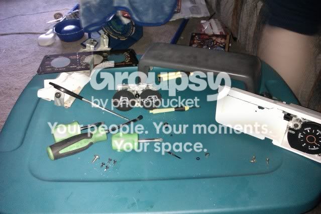

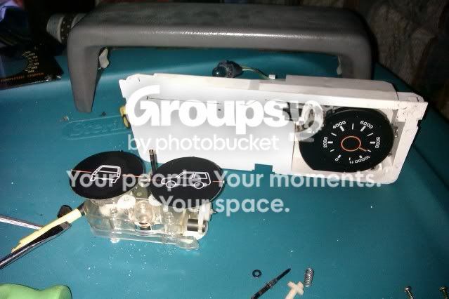

While we were there we got a few odds and ends and goodies for the trucks, one of the goodies was an oem altimeter from an 88 t4r. I got everything wiring and bracket for 50 bucks. The altimeter and inclinometer both work.....but the"adjust" knob for the inclinometer doesn't do any thing. It will free turn and pull out but it doesn't adjust anything. I decided to take it apart and well I can't figure out how to get the shaft that connect to the knob to adjust what its suppose to adjust( and a spring and sproket fell out and I don't know where they go)
Does any one have one the can take a pic of the gears for me? Or any ever had theirs apart??
Thanks! Ill post pics of the dissassembly when I can.
IMAG0216.jpg~original
You can see the sproket spring and shaft along the bottom of this pic
IMAG0218.jpg~original
Disassembled

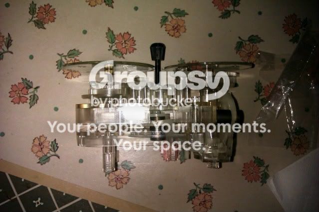

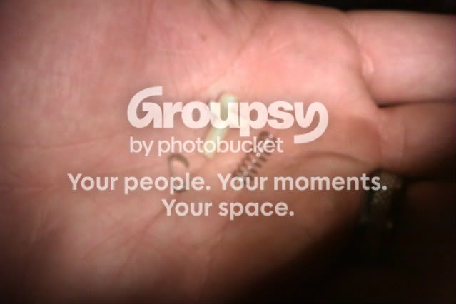

Thanks! I'm not missing any of the pieces I have everything. The sproket/spring for the "adjust" knob aren't where they need to be. See the first pic, I need to know where the spring goes so I can get the adjust knob to work properly.
could any of you get me a pic of yours taken apart.?a view from the bottom like this so i can see where this spring is suppose to go and i can get this working? also a close up pic of the gears also from the bottom.
IMAG0220.jpg~original
here is a better pic of said sproket and spring....and a misc metal part
