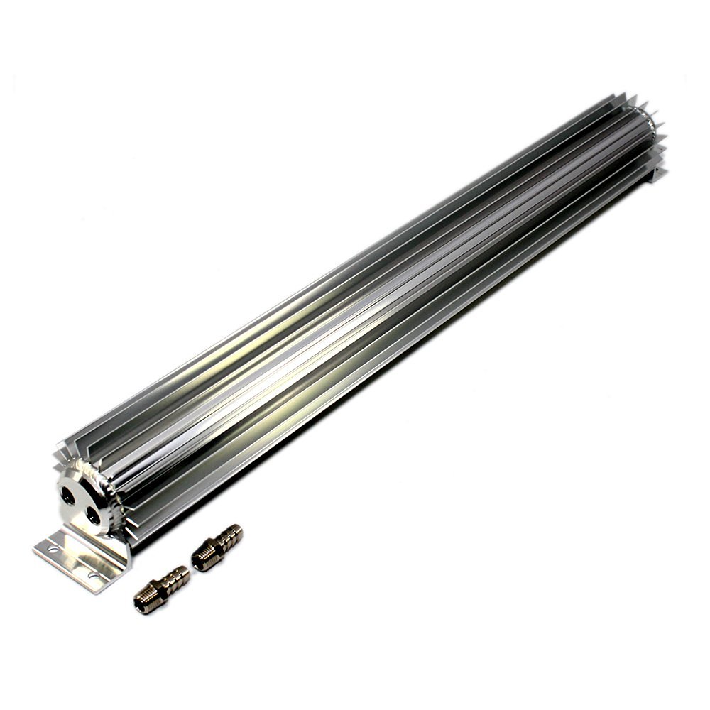

My concern would be that it doesn't appear to be self-regulating. Many of the B & M coolers feature low temperature bypass channels, to allow trans fluid to bypass the cooler until it's brought up to temp. Remember, flat cooling of the trans isn't what we're after, but instead proper operating temperature. A cold transmission isn't much happier than an overly hot one, so it's important to bring them up to temp asap.
Low temp bypass circuit described here.
We've used similar ones to that for power steering coolers, it won't significantly drop trans temp I don't think, but a before and after would be cool to see.
Honestly that was my concern was that it wouldn't do enough. With the type of driving I do having my transmission to cold never is an issue because it's constantly hot in heavy duty 4 Wheeling
