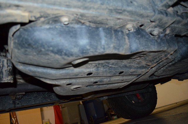

These are the stock skids; I'll take the extra weight of steel for the replacements.

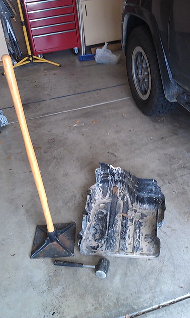

I 'fixed' the dent in the gas tank skid plate, but will be switching to Shrockworks skids.

Yeah... Scraped up the support bar on the passenger slider and dented the gas tank skid. Didn't tell the wife about the size of the dent until after we got home LOL otherwise the fun would likely have been over in Ouray. I still got the "you can dent the crap out the gas tank, but you complain when I park at Walmart!" speech LMAO. :hello:
