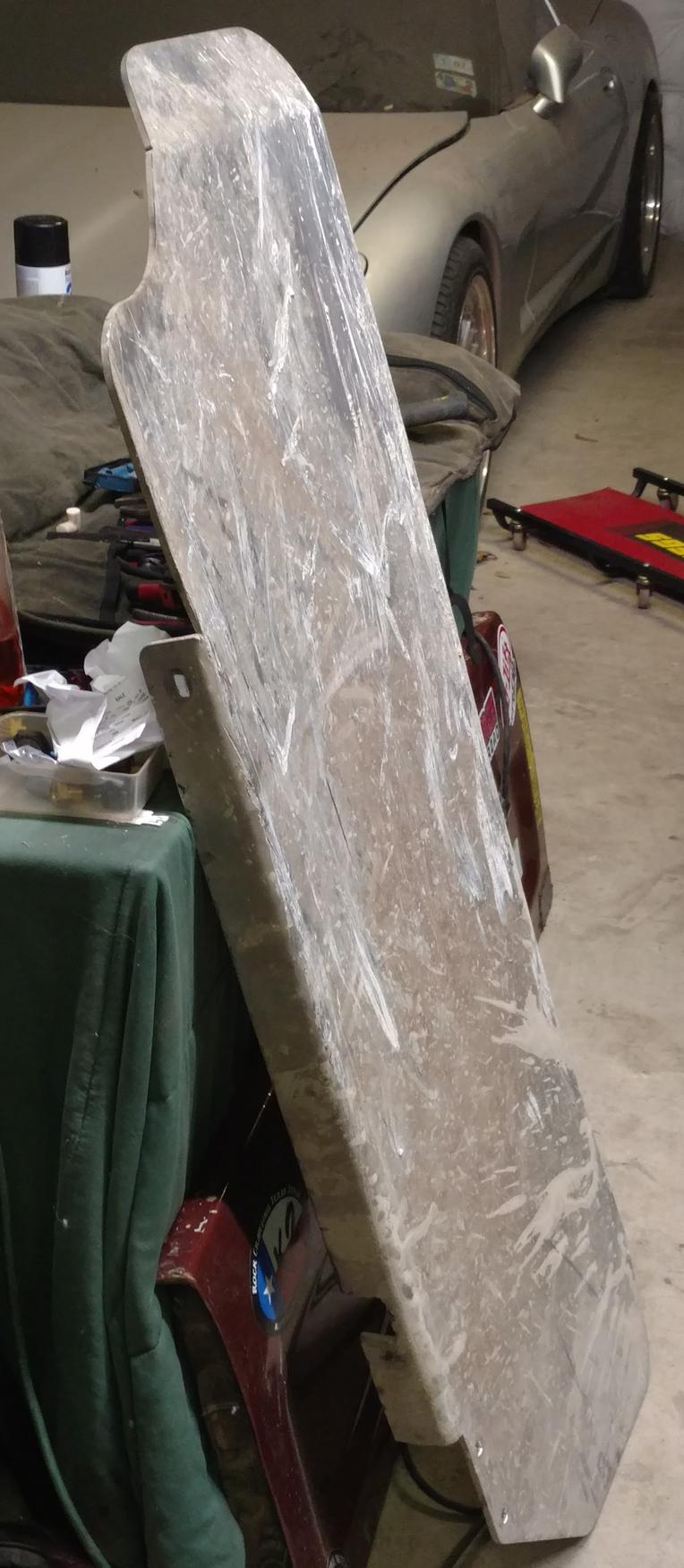

Here is what my aluminum RCI gas tank skids looks like after a ton of offroad miles in extreme rocks and ledge... can't possibly count how many times I have hit it. It's beat up good, but still 100% functional and no rust.....
